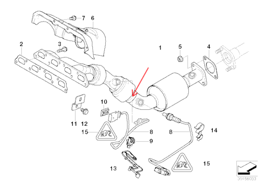

Guy at the exhaust shop today told me It cannot be welded because of the double wall around the cat. Gave me an estimate for 1. Front LEV (low emission) OBD 2 Converter for 757.59 total. Ugh.
The arrow shows where the weld broke. Any suggestions on an exhaust replacement? If I have to spend the money then I might as well get something worth it unless y'all believe OEM is better. My county my car is registered in doesn't require emissions so I'm not too worried there, but I don't want the CEL light constantly on.

This can be fixed on the car. The 03 i bought last June has been repaired. The cover part of the converter needs to be trimmed back in order to weld the seam. I would try another muffler shop maybe a mom and pop type shop.

Yeah there are two other exhaust shops around here and if they can't do it, I might just try to find a general welder to take care of it for me. I even told them to try and weld it today and the place seemed really hesitant. Could just be looking for a bigger payoff from me instead of actually trying.

Mine cracked there as well, so I removed the exhaust system and had it welded for $65.00. That included them cutting back the cover by an inch or so and doing a beautiful weld job. It has lasted for three years so far.

My 06 S did the same thing. I took it a muffler shop and the guy threw it on a lift and welded the exact same area you are having an issue with. He basically filled in the gap where the two pieces were pressed together. 10 minutes and $30 bucks and I was a happy camper. Its been fine for over 2 years now.
