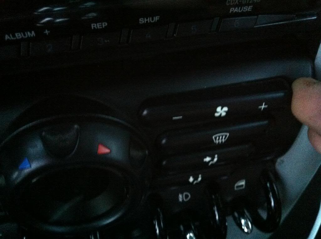

Problem number 1: the fan control button. The fan speed up side is fine, but the side to turn it down has no resistance. Its like the button is stuck inside the thing. Ive tried my best to take a picture:
As you can see, the button pushes in on the - side, but there is no button being pushed behind it. Is there a way I can take it apart to see if the button can be unstuck?

Bet something sticky splashed on the fan button....has happened to mine...a sugared soda or coffe...a bump....
Try a few drips of water on a q-tip, then some plastic safe contact cleaner speayed in with the tube...should unstick it.

Would that fix the button inside it though? The button i took the picture of flops around loosely

Can't hurt it.
the spring/button behind it was stuck/gummed up.
If it does not fix it, just buy a new/used one....they pop up from folks parting out cars.
