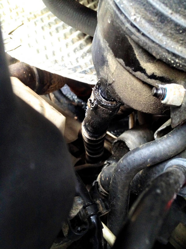

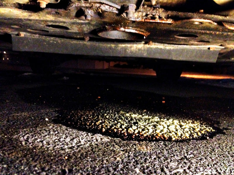

OK, hope you guys can help me out here. I bought my first MINI 2 months ago, a 2003 R53 MCS 6spd with 156k on her (purchased for $6k to a private party). I purchased her because I was looking for a reliable & economical but fun car that was good in the snow to get me to my new job, 35 miles away. The car came with 2 sets of wheels, the 17" MINI sports with good summer tires, and an almost new set of blizzaks on generic 16" wheels. The car also had receipts for a bunch of major work recently done – Thermostat & Gasket Replace, Cooling System Flush, Cooling System Flush, Starter, Supercharger Assembly, Belts, Water Pump, etc. All in all almost $4k in work done at 148k.
Well, in the couple hundred miles I've put on her I have seen the Serp Belt Snap and leave me stranded due to a bad tensioner (had a shop replace that for me) (only 8k on the belt!). Then I got the car back and have a SES/CEL light on with two codes. Then I sprung a major power steering leak – reservoir is completely dry and I'm afraid to drive it 'cause I don't want to burn up the power steering pump. It looks like the power steering leak is from the return hose just below the reservoir, but I don't know if it's leaking from anywhere else (pouring out onto my driveway) – I'll attach pics below.
Don't want to dump a ton of money into her, and thought she'd be a descent DD for the next year or so without too many issues (due to all the recent work and good maintenance history). All this to say I'm pretty frustrated right now…
So, two questions for y'all.
1) How do I diagnose these fault codes?
P1688 -> crank pulley issue??
P1477 -> Leakage Diagnostic Pump Reed Switch Did Not Open
2) What have I gotten myself into – patch & dump or fix & experience greener pastures ahead? I'm tempted to patch up the car, cut my losses and sell her before I have anything else go wrong. Or should I fork out the dough to a MINI shop to do a full workup on her and then drive her for the next year+? Just don't like the pattern I'm seeing here so far… I thought a MINI S made great sense for what I need right now (great MPG, fun commuter car, good in MN snow, etc)… I'm just missing the reliability piece and I'm pretty discouraged.

The ps hose can be replaced pretty easy....
Sounds like the work done was WAY overpriced....
Look at the crank pulley...when they start to slip, you can smell the rubber, snd wiggle it side to side a but....a reliable mini with so many miles...lol. just hold onto your wallet...$2000 clutches, and $600-1000 ps pumps, and $800-1000 alternators might be due...then add the ac compressor...maybe s cv joint......front bushing for steering, struts, etc....you have an end of life car....unless you put up with stuff....or diy them to save $$, it WILL get $$$. As a matter of fact, very few mini's have miles as high as yours in comprassion to the number on the road....

You might have a solid crank pulley replacement....hard on the bearing/ oil pump, but cheap...two aftermarket dampers with dampening like oem are ati and prc gel one...both look different, but function better/longer than the oem rubber one that fatigues...a bit cheaper in some cases.
the second you list is an evoprative emissions code (i think)...has to do with the slight vac applied to the tank i think.
