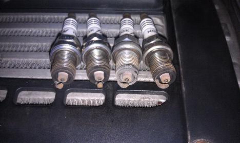

Pulled the codes this morning (P2300 Ignition Coil "A" Primary Control Circuit Low/ P2303 Ignition Coil "B" Control Circuit Low). Researched it and quite a bit came up but any advice? Recap- car runs perfect all the sudden it will just shut down and either restart like nothing happend or have to wait a few min. And it will start back up caught and fart a sec then is fine, new coil, new wires. pulled pluggs and #2 is a whitish color. "pic flipped". Help me!

Damn, that one looks like it's been burning way too hot or something....is the electrode on that plug gone or shorter ( burned off ) than the others ?
Those are random misfire codes I think and the last number indicates actual cylinder where they are ocurring...So it's cylinder #3 you are idicating as number 2.
I would change the plug wires if one is bad the rest are not far behind. Take a look down into the rubber boot of #3 wire where it attaches to the coil...check the connector, it's probably corroded in there.
Dont use stock wires with non stock coil pack and visa versa. Been there done that. Unless you are willing to pull the #3 off and put dialectrice grease onto the connectors every 5K miles.....

Looking at the picture the 3rd plug from the left (white one) is cyl. #2... It's not melted or burnt any but I'm gonna order plugs tonight. It has KARLYN-STI high performance wires (pretty cracked and shot) and NGK iridium plugs, had an msd coil but that pooped a month ago so I just put a stock one back on her. So your saying stock coil I should run stock wires?

Cylinders in our MINI's are numbered as follows, while stading infront of the bonnet from L-R #1 on far left pass side.
Firing order is 1 3 4 2.
If the plug came from the second spot in from drivers side then that would be cylinder #3.
When I ran stock wires and CP, I only had dark petina on #3 CP post. When I added aftermarket wires I had a code and god aweful corrosion. Remedy for me was going with MSD CP and MSD Wires.
I will post back up after 1 yr with check of #3 CP Post.

Somehow my darn phone flipped the picture, if standing at bonnet it woukd be 2nd from left (pass. Side) is white plug sorry for confusion and as of 2 weeks the car has not throw the code I found the 3 wire plug into coil has the clip broke and was not on all the was it seems but I will still change wires!
