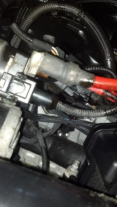

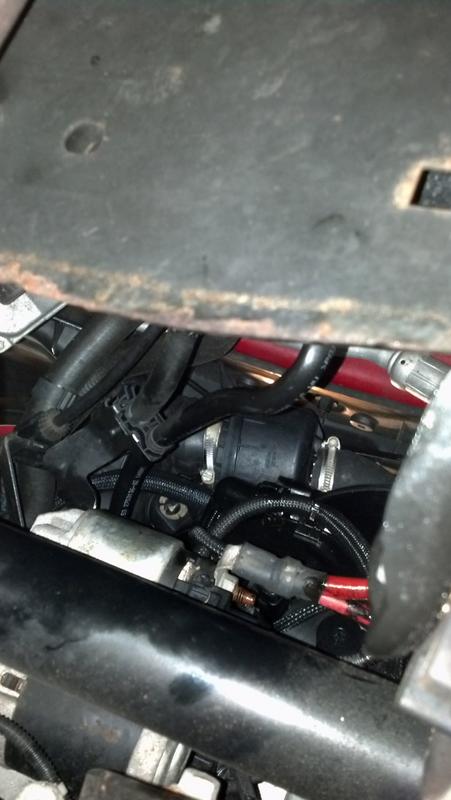

OK, here is the long story of DIY replacing R56 Pressure Converter (PC) with pictures (hopefully they uploaded correctly).
Tools required:
- lots of portable light sources
- lots of surgical rubber gloves (you will tear a few)
- jeweler's flat-head screw drivers to help disconnect fasteners from the old PC
- whatever it takes to safely jack the nose of the car up and put it on jack stands
- optional: paper towels and rags to clean up the dirt and oil residue, if you are so inclined.
Step 1: Jack up the front of the car and support it with sturdy jack stands. As high as you can, as the extra height will give you more elbow room you will appreciate down the road. If you have never done this before, search the forums or drop me a line on how to do this safely.
Step 2: After the engine has been off for ~1 hour (you will be hugging the exhaust pipe - don't get burned), climb underneath the engine with all available sources of light, and a small flat screw driver. With your feet facing forward, you will see what I pictured. One picture that is 1/2 obscured by the nose undertray shows the orientation. The second picture is a closeup of the area we care about, right above the 2 red wires.
Step 3. Look at the 2nd pic right past the double red-wire element. You can see the connector to the PC. The rest of the PC plastic body is partially obscured by those two red wire connector, but not to worry. The rubber enclosure around the PC is impaled on a metal "blade" attached to the intake manifold, positioned across the center-line of the car. Push/tug it sideways from passenger to driver side. It will wiggle off the mount and drop down below the red connectors into clear view (and too close for my camera to focus).
Step 4: Unplug 1 electrical connector and 2 vacuum hoses from the old PC, plug them into the new PC. BEWARE: when I unplugged the vacuum lines, my old PC let out a long ferocious groan that prompted me to instinctively pull my hands back out in hurry, and whack them on the exhaust pipe.
If necessary, you can get more wiggle room and drop the PC further down into your grasp by unclipping one of the clamps holding the shorter vacuum hose to the intake manifold (it's the one depicted doing upside-down-U arch north of PC wiring loop on the close-up pic).
Step 5: Briefly test start/stop the engine to make sure everything works and the shut-down groan is gone for good (you can delay this until step 6 as well). Turn the engine off quickly before exhaust pipe gets hot, then climb back down under the engine bay. Now shove the new PC onto the blade mount. It will be somewhat tricky as you will have to work blind, but there is nothing to break by trying too hard, so just give it a push with a wiggle and it will slide back in place.
Step 6: Jack the car back down from jack-stands. Go for a test drive. Have a beer and pat yourself on the back.
Hope this helps,
alex f
