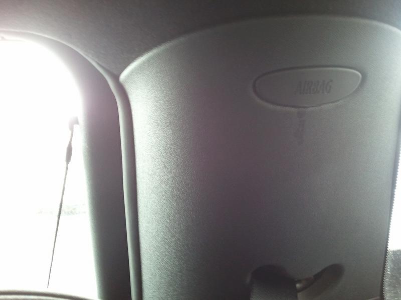

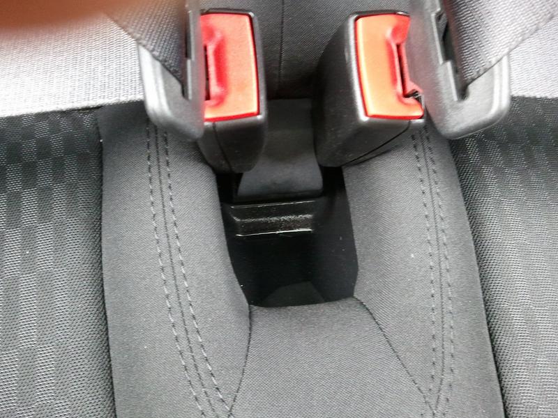

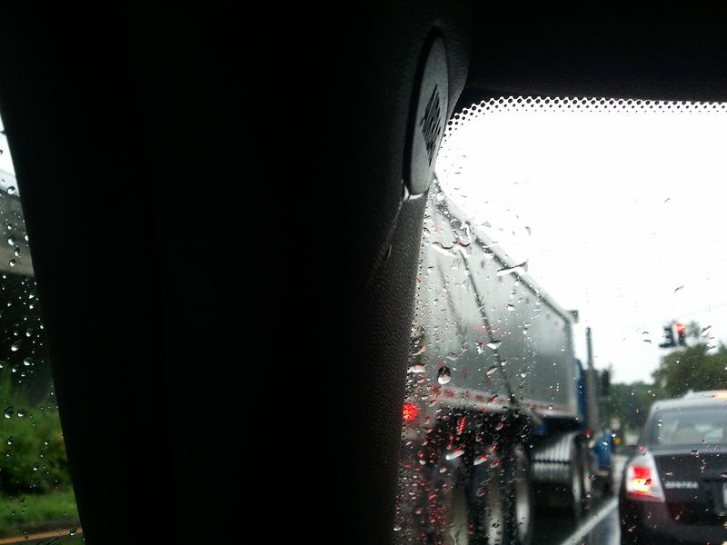

It's still raining today on Saturday, and this morning I was driving and although there wasn't mist inside the car this time, I found out that water was leaking in from the four corners below the headliners from the 'airbag' sign. Also, the rear seat is completely soaked!
I'm going to drop of my car next week, and they'll probably look at the leaks, but the soaked seats really bothers me, and also I'm worried if the airbags will work when it's probably all wet now.
Any suggestions on why water is leaking from the 'airbag' signs, and what I should request from the dealership?

Some or all of the sunroof drains tubes (all four corners) are either pinched off, missing, or plugged up. Sunroofs in cars don't completely seal (just like your door windows), the seals block most of the water, and the water that enters the sunroof (or doors) drains down and out of the vehicle.
I wouldn't worry too much about the side airbag system because if there was a problem the airbag light would light up, but I would worry more about the computer modules under the front seats (ABS/Stability Control, bluetooth, sat tuner) more so as those could be potentially sitting in water. Also, the SPEG computer module (and fuse box) located on passenger (right) side the kick panel could be getting dripped on as well. And alternatively on the left side kick panel of the car, the FRM module (mostly lighting and windows) could be getting wet as well.
