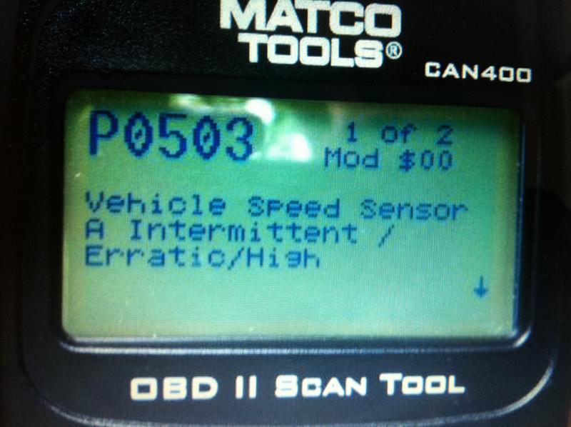

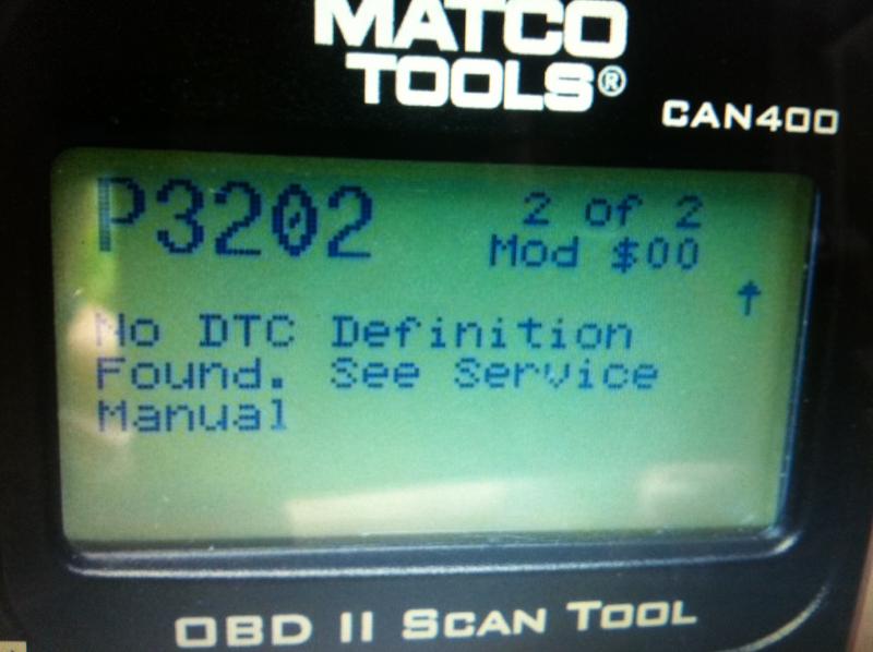

Has anyone had any experience with these codes? What exactly do they mean?
Has anyone found a solution to these codes other than taking the mini to the dealer? I'm out of warranty
P3202 - Powertrain CAN chip cut off
-or-
P3202 - PT CAN communications fault: CAN bus off or CAN bus defective
P0503 - Vehicle Speed Sensor 'A' Intermittent/Erratic - Signal too high
Thank you for your replies!

* MINI DTC P0503 (0x32D0) - Vehicle Speed: Signal Too High
* MINI DTC P3202 (0x3091) - Powertrain (PT) CAN Communications Fault: CAN-BUS off or CAN-BUS Defective
The ECU is seeing that the vehicle speed sensor that relays the speed back for the instrument cluster.
Test the sensor for proper resistance, if it doesn't hold to spec, replace it.
As for the CAN-BUS fault, are you having any problems with the engine sputtering or 'trying to catch itself' when the RPMs flutter?
Does the scanned car have an automatic transmission?
Other than the ECU not being able to communicate with the powertrain module, does it impede on drivability?
- Erik
