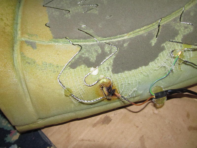

This happened to me when I retrofitted some used heated seats in mine. After a day of ripping the interior apart to install the wiring, I turned the seat on and it burned through the seat cover!
It is a manufacturing defect. There is something like hot glue that is supposed to cover the wire where in connects to the heating element. On some seats, this protective coating does not cover the bare wire leaving it to corrode. Ultimately, the resistance becomes too great at that junction and it burns through the seat.
Took mine to dealer after it happened, and they were just going to charge me for new seats. Ended up putting in aftermarket seat heaters using the factory wiring.
You could probably fix it by trimming the corroded wire, re-soldering, and encapsulating the joint in hot glue to protect it from corrosion.
Attached Thumbnails Heated Seat - Heating element burn/melt seat cover-img_1998.jpg   Heated Seat - Heating element burn/melt seat cover-img_1977.jpg

The connections that corrode for the seat heaters are near the back of the seat bottom and bottom of the seat back. However, I don't think you're going to be able to fold back the seat cover enough to access those points with the seat still in the car. Even if you could, with a soldering iron in there to fix it, you'd risk burning through seat cover.
Pulling the seat out really isn't all that bad - disconnect the battery, disconnect the connectors, then 4 torx bolts and you're done. Taking the seat apart to remove the covers is a little more involved, but I have a how-to with pictures which helped a lot. PM if you want a copy.

A few more pictures of where the joints had corroded. The silver braid wire is the heating element - it doesn't seem prone corrode. Where the wiring harness attaches to the heating element, you can see the exposed copper which is the culprit. The joints that didn't corrode are properly sealed with some kind of silicone or plastic encasing.
Attached Thumbnails Heated Seat - Heating element burn/melt seat cover-img_1978.jpg   Heated Seat - Heating element burn/melt seat cover-img_1983.jpg
