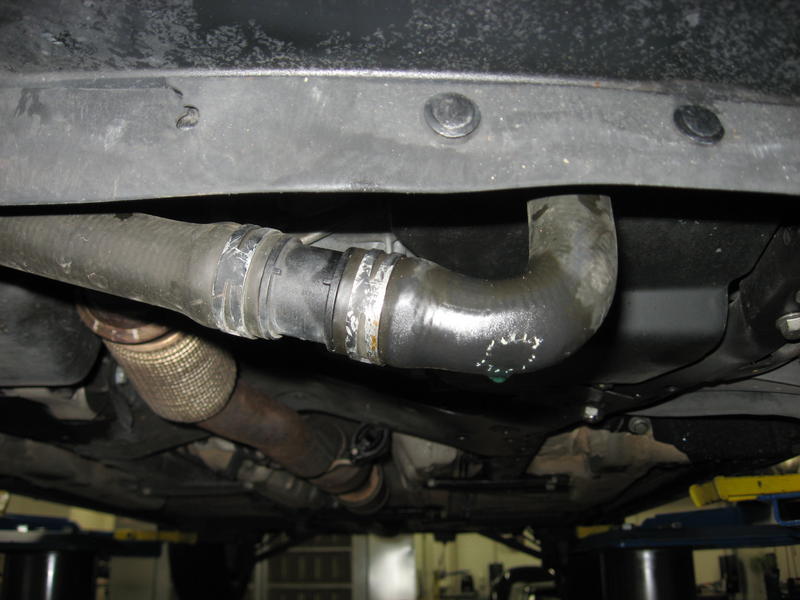

Here is a photo of the damage

Hi Woody--I'm one of those you mentioned. My wife fortunately spotted the drooping hose as I pulled up our driveway (on a hill) before anything leaked. In the photo it looks like the vertical plastic has a small tear? Mine didn't suffer that, but most of the plastic clips did break, allowing the hose to fall lower. The dealership replaced the clips for me free of charge, and did say it was a poor design.
Sounds like you just need to replace the hose, clips, and coolant? Engine didn't overheat or anything catastrophic, did it?

And yes my car overheated...that is how I found out the hose had dropped down. Not sure if that caused any additional damage yet.

It doesn't help that your spoiler looks damaged like you hit something so I can see why your dealer is fighting it. I agree the hose should be a little more protected though.
