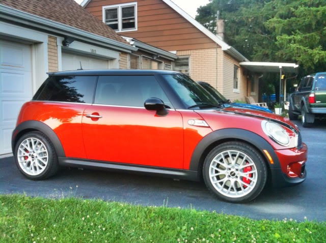

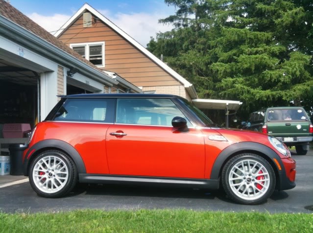

I would think that the tint company would have to over ride that feature when they put the tint on anyway. I would assume that they would put the tint on with the door open. When the door opens and does its drop they would not be able to tint the windo fully. I had an 08 and now a 11. I had the windows and sunroofs tinted in the 11. I never asked how they did it, but you must not use the windows for 3 days I think. They are afraid the tint comes off. They had a warning taped over my window controls so I would not use them. What sucked is I was going to the shore the next day and could not open my windo to pay for tolls.
Also, it looked like crap when I picked up the car. They said it would look better when it dried. I really did not believe them, but it took about 3 days and now it looks great.
Before:
After:
Before:
After:
