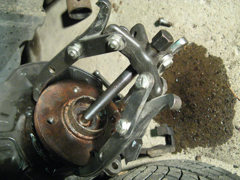

Hi all.
Well. I used a steering wheel puller to move the axle in. Where do I go from here? Sorry for the size of the files. My computer that I use for shrinking jpgs is on a large cloning job right now.

Thought I was kind of silly to post that last post. I realized that I know what to do. I have built several Caterhams, rebuilt a few Lotus Elans and I am asking a stupid question. I guess I am getting too cautious in my old age. Just being unfamilar and not being able to afford to make a mistake has got me spooked.
Anyways. All set. Here is the picture of the assembly off the car and then one that shows where the speed sensor is.
