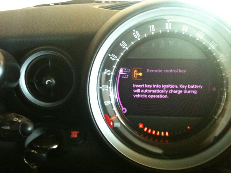

Well, I had to take my JCW to the dealers today for it's first minor issue. I have been getting an error when I insert my key to start the car. I don't think anyone at the dealers has seen this error because after I told them what it does, my response is "Huh??"
Anybody care to take a stab at the cause of this error? I attached a photo I took to give the service guy at the dealers. I can sat that the key is NOT the problem because my spare reacts the same way.

well a couple of things to note for you.
1. If you have Comfort Access then the keys DO NOT charge in the slot they have replaceable batteries and this my just be the cars way of saying that you need to replace the batteries.
2. If you do not have Comfort Access then the Keys do charge in the slot and it may mean that the batteries in the keys are bad or not charged. it could also mean that the charging circuit in the car is bad and not charging the keys properly.

I haven't witnessed that exact message but mine did post a message recently regarding the FOB battery charge. I have the comfort access and had to replace the batt in the FOB to get rid of the message. Dealer said it would charge if I inserted it into the car. But, as previously stated, this did not work.

Non Comfort Access vehicles will display the message in the picture above. Looks like a problem with the charging portion of the ignition slot on the vehicle side. I'm sure your dealer will diagnose the problem. Comfort Access vehicles will display a similar message, but instead of asking to insert the fob into the key slot, it will say replace the battery in the key fob.
Comfort Access vehicles have different key fobs than non comfort access. Comfort Access vehicle fobs have a removable battery cover on the back where non Comfort Access do not. Non Comfort Access fobs also have two metal charging tabs on the back of the fob. Comfort Access fobs do not. You cannot replace a battery in a non Comfort Access fob. The fob is sealed.
Comfort Access key fobs do not have the capability to charge and do not charge in the slot, that's whey they have replaceable batteries. This is because the fob is hardly ever in the ignition slot. It's not necessary. Dealers are misinforming MINI owner's saying that it will charge in the slot when it does not.
