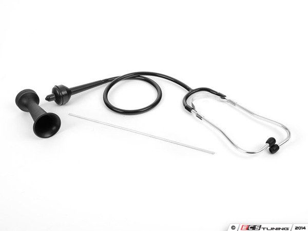

Old Jun 22, 2015 | 02:51 PM
  #71
Posts: 36,768
Likes: 2,553
Isolated the noise or use a Stethoscope ,
http://www.ecstuning.com/Search/SiteSearch/ES2762259/
