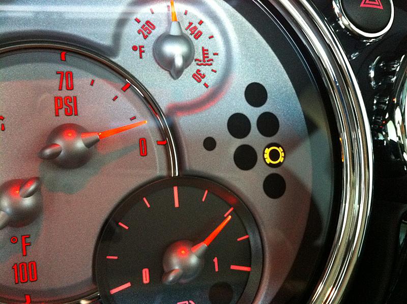

What is this indicator light means?
Need help folks ...my guess is a brake indicator of some sort.
Thanks.
.a
Old May 4, 2011 | 09:06 AM
Capt_bj's Avatar
Capt_bj
Posts: 7,037
Likes: 283
From: Melbourne, FL
brakes have worn enuf to trip one of the sensors... need a visual check to determine if it is front or rear
you need to replace those pads and the consumed sensor. generally the rotors would be changed too but you many be able to go w/out
First of all, thank you. That's what I thought. Another question, while I have your attention. Could I fit the R56 JCW big brakes to an R53 for the front and rear?
