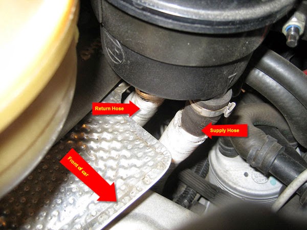

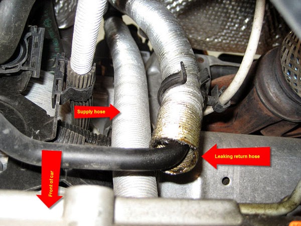

Originally Posted by TigerDave
Thanks to the members, I was able to replace the power steering fluid return hose on my 2006 S. The fluid return hose appeared to be dripping onto the power steering pump which then bled onto the garage floor.
It took 5 hours start-to-finish (because I took my time and had to make two runs to find the right sized socket (22mm), swivel adapter, and extension bar to access and remove the bolt).
The replacement hose was $68 at Pelican Parts. The fluid was $22. The crush washers they sent me were the wrong part (too small) so I was forced to re-use the existing ones. Will keep an eye on it and if they leak, I'll buy the correct size (which means draining the PS fluid again (messy and pricey).
Here are some pics of what I saw.

I posted them above in order. Post #55.
