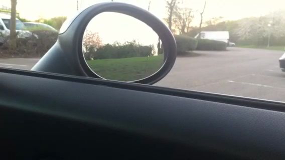

Window squeal / squeak!!
So I washed my car two days ago and since my drivers window has squeaked and squealed! Someone relieve me of the agonising sound!! Please?
Video attached for amusement

hahaaha I am sorry but that sound was kinda funny when I played it
on the serious note is this coming from the window touching frame or what? How about some WD 40 after You take that inside panel off and spray around?
Just and idea..

Tbh, I do find it quite funny. Just annoying in public lol!
and the squeak seems to be coming from the rubber. There are two however, mine seems to be the one below the one you'd rest your arm on. (Rubber where window goes down, another beneath this.)
Tried to apply talc to it but no luck.
Think i need to take the door card off and have a go. Not sure if this is as easy as it sounds though?
