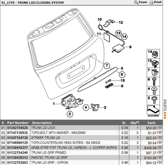

Sorry that it appears your issue is a part failure, and not something simple. The prices you were quoted seem a bit high however. I have been using a dealer based web site that lists the unpainted trunk lid grip for about $98 or a chromed one for about $96. They also list a painted one for $193. Here is the site URL if you are interested: http://www.penskeparts.com/fiche.aspx?brand=mini
Once on the site, you will need to select your year/model of MINI and it will bring you to the dealer fiche files for all of the parts groups on your car. You will want to go to group 41-Bodywork and look for digram labled Trunk Lid/Closing System (see attached). From there you can order online and have it shipped to you.
I hope this information is of help.
