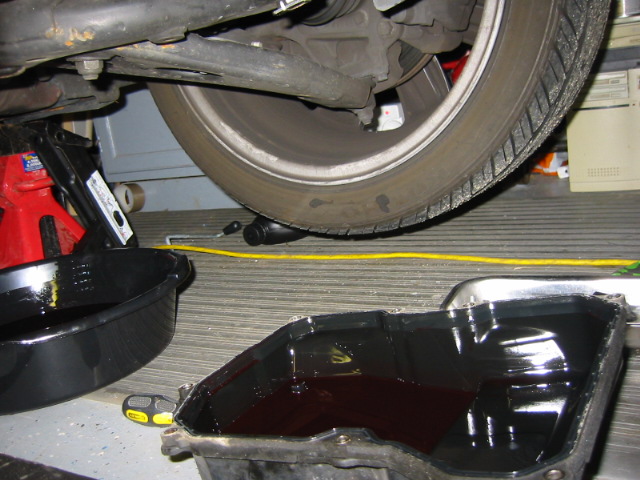

I drained as much transmission fluid as I could before I jacked my car up but you could do this after you have it elevated.

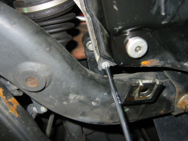

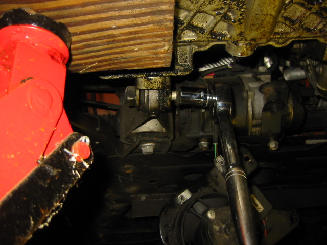

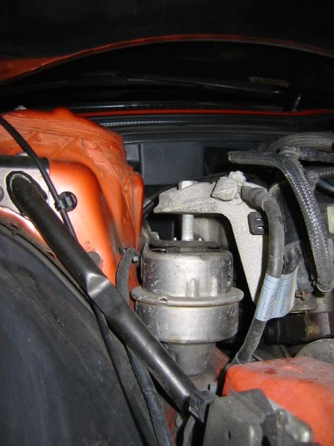

Loosen/remove top passenger side engine mount bolt. Set parking brake on, jack front of the car up and put on jack stands:
Remove plastic splash guard under car. Remove power steering cover if your car is equipped with one. Remove power steering fan or let dangle. Place jack with wooden blocks under engine block. Remove bolt from bottom engine mount:
Carefully jack up the engine about 2-3 inches tilting the engine to be able to access the hidden t30 bolt
You only have just enough room for a thin diameter, long shaft T handle wrench to access this bolt.

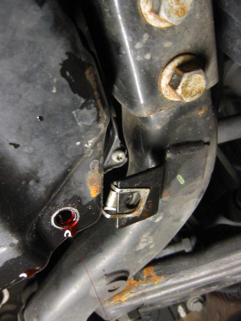

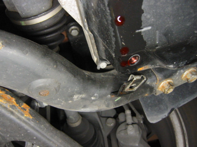

There is another hidden, but not as difficult t30 bolt to remove near the drain hole

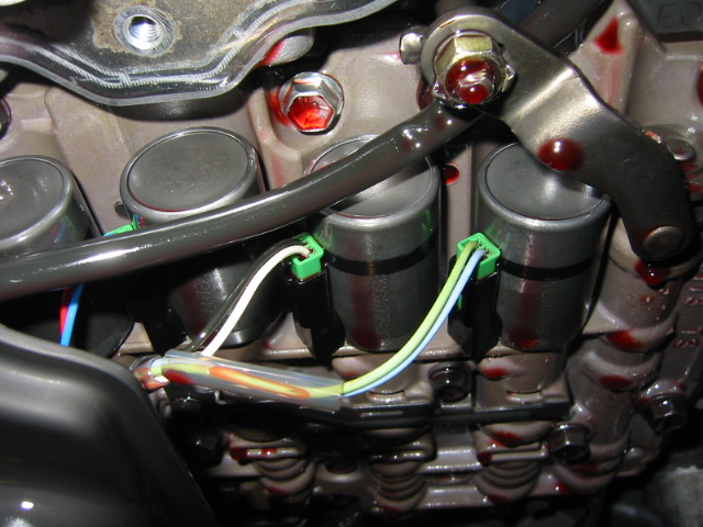

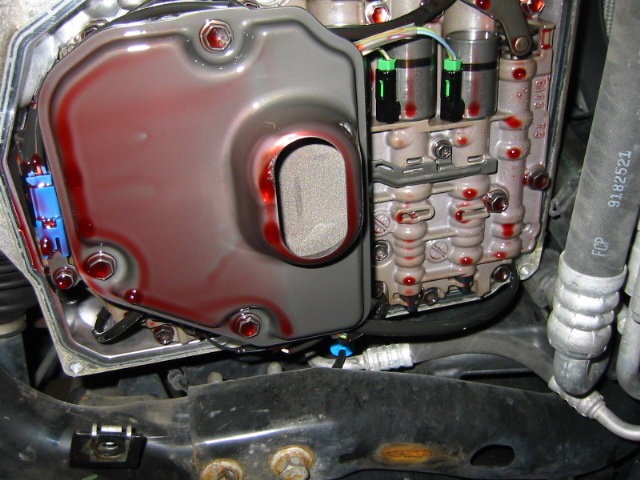

Unscrew 3 bolts to remove transmission filter and then get you an old pillow or jacket to put under your head while you carefully and gingerly remove these wire connectors. Make sure you have some safety goggles on. I used a small jewelers/eyeglass repair screwdriver to push in the locking extension and long nose pliers to grip the plug to remove. This part may take some time; don't rush. Also pictured below is the selector arm. You have to bend back the retainer tabs around the nut to remove it. Once the nut is removed you may need to grasp it with pliers and gently rock it to be able to pull it off.
To remove the oil temperature sensor in the center of the valve body you have to unscrew the bolt unlocking a metal bracket first to allow you to pull it straight down. Be careful because more fluid with flow out of that hole!
(this pic shows the oil temp sensor but the valve body has been removed already)

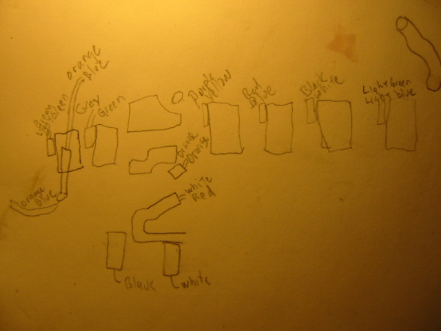

For what it's worth here's a quick sketch of the wire placement:

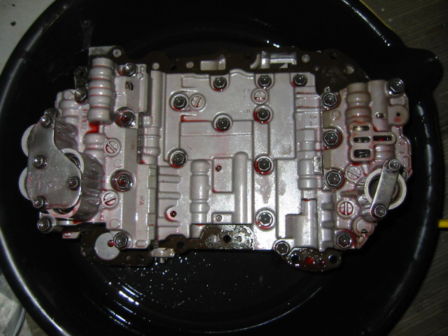

Here's a view with the valve body removed
Backside of valve body
Clean everything up and reinstall with your rebuilt/new valve body. I'm using new bolts for the valve body to transmission but not really sure if it is necessary. The torque specs are on the Bentley guide. It also calls for 4.8 US quart (4.5 liters) need for refill but for some reason mine had close to 6.

While you are unscrewing bolt number 12 support the valve body (I estimate it weighs about 15 pounds or so) and look for the accumulator plunger and spring to fall out of the transmission body.
