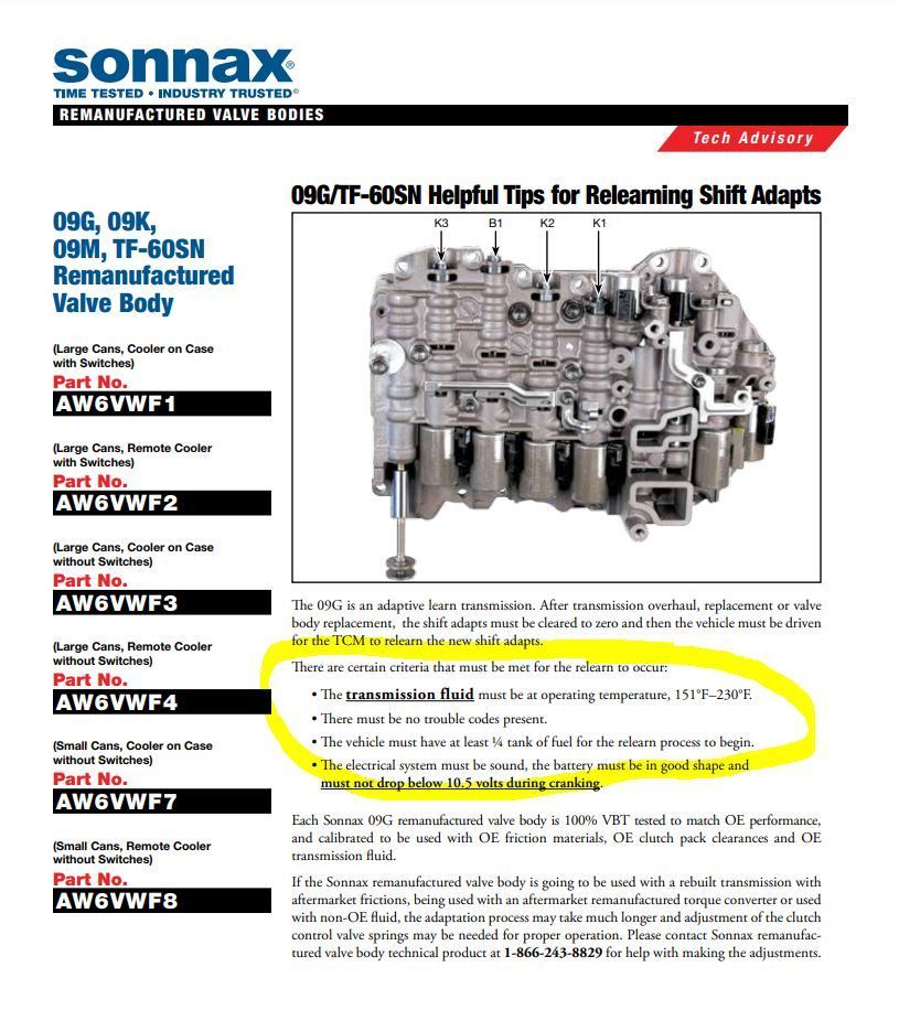

Here’s a quick update on my situation. The hard shifts from 1st to 2nd and weak shifts from 2nd to 3rd never resolved themselves. I reached out to RevMax and they agreed to send me out another rebuilt valve body. I replaced everything one more time. After refilling, releveling, and resetting the adaptations once again using ISTA+, I was presented initially with a VERY smooth 1st to 2nd shift, and the 2nd the 3rd weak shift was also resolved. However, I had a new problem... 3rd to 4th (which was completely fine in the original VB and the 1st replacement) was now slipping quite a bit (around 600 RPM’s or so, maybe more). It got a little better after driving for 20 min or so, but not much. Then I remembered reading something on Sonnax’s site about how you can’t have any fault codes when going through the relearning process, as well as you have to have over 1/4 tank of gas I believe it was. I was almost on empty, so I pulled into a gas station and filled it up. IMMEDIATELY upon pulling out, the problem from 3rd to 4th was 100% gone. No slipping... not even once! So HUGE lesson learned and hopefully this will help someone out there. When you start the relearn process after resetting the adaptations, be sure you’re gas level is well over 1/4 tank!
It’s been a couple weeks since the 2nd VM was swapped and... wouldn’t you know... my daughter told me she’s experiencing more rough shifting from 1st to 2nd gear!!!!! AAAAHHHHHH!!!!!!!! She said she thought it was mostly when she started driving for the day, while the tranny fluid was not warmed up yet. I just took it out tonight and confirmed her beliefs. It’s not nearly as rough as with the 1st VB replacement from RevMax, but it’s still a bit choppy and bouncy from 1st to 2nd. However, after about 5 min of driving or so, it smoothed right out and I no longer felt anything rough once the tranny fluid was good and warm. Is this just something I’m going to have to live with?? Does anybody else experience any rough shifting at all while cold, which goes away once warmed up?

Did you try checking the fluid again. Maybe it needs another 4oz.

Good point. Maybe you're a tad low on fluid?
What does you gas tank level have to do with transmission shifts? That's very interesting.
Did you reach out to RevMx again?
I was going to test that out today. I made a sweet little device that allows me to pump tranny fluid up into the pan through the lookout, so at least that'll be easy. And monitoring the tranny fluid temp with ISTA+ is also a God-send!!! I highly recommend. Here's a link and screenshot to the Sonnax pdf about the relearn process:

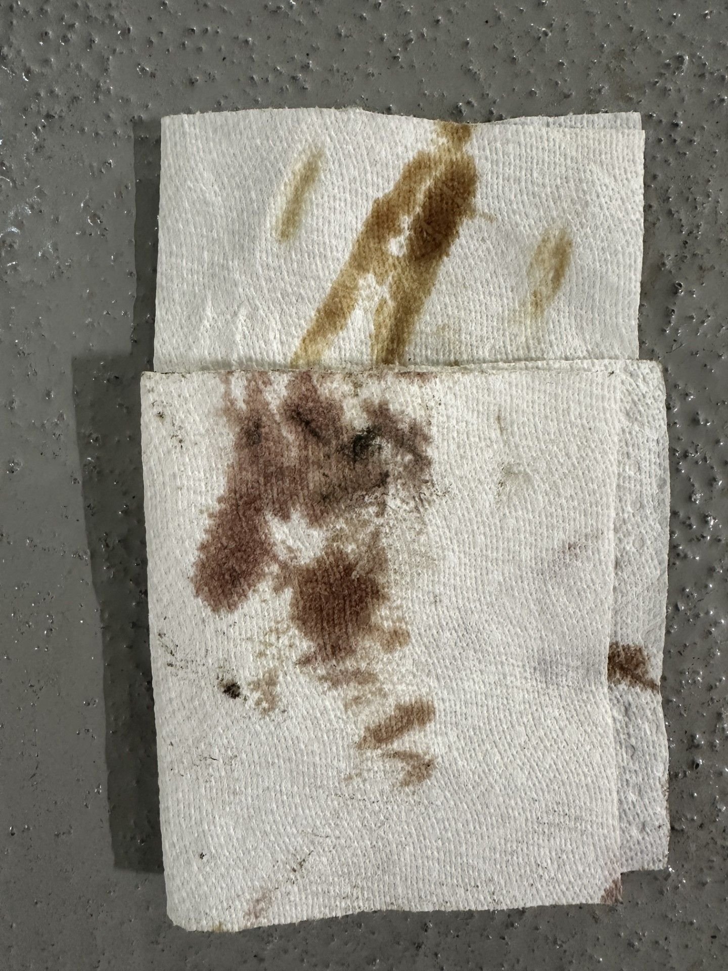

AISIN 6 SPEED auto internal leak help!
Hi, I have a 2005 cooper s, 175K km, at 100K (2012) had the valve body rebuilt and is still shifting very smoothly, however recently noticed drops of red fluid on passenger side, I assume this is transmission fluid as it's pooling along the edge of the oil pan and dripping below the engine mount knuckle. I also found that it's seeping between where the transmission is mounted to the engine and the pan is not leaking. I fear this is a very expensive seal repair and may not be worth keeping the car after 21 years. I've had a lot of work done over the years, most recent items. I have some pictures of the leaks I also researched that if the inspection hole is clean which it is then the leak could be external perhaps passenger side output shaft seal but I haven't taken it in to investigate yet as I'm afraid to drive it and cause damage.

Hi, Update: Took it to the dealer today and together with the shop manager we looked at it and we could not trace the leak to the transmission, both output shaft seals were dry and clean and even inside the inspection hole in the bell housing was clean. It's a mystery we did trace some of the red fluid pooling at the oil filter housing area which is bizarre. He said to keep an eye on it did not look critical at the moment and will have to revisit maybe when I get an oil change in a month or so.

Hi, updated I'm convinced it is an ATF leak and now I suspect it is internal as I did a short couple of trips and it accumulated again on the passenger side it must be forcing it's way along the engin oil pan. I got a sample on my finger to smell it and it did not smell like engine oil. But car still shifts and drives ok for now, I will not be driving it until I get to the bottom of it but I am also not spending thousands to take it off the car not at this age and KM, 175K km. I am the original owner, it has new tires and radiator fan, PS pump is only a couple years old too. Perhaps I will try to sell it for anyone who wants some really good parts.
