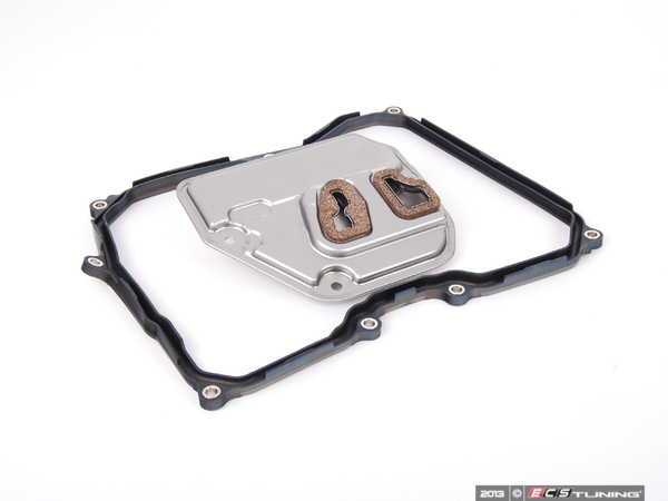

And the filter Kit: R52 Cooper S auto, R52 Cooper S Auto
http://www.ecstuning.com/Search/24347551087KT/ES2602655/
