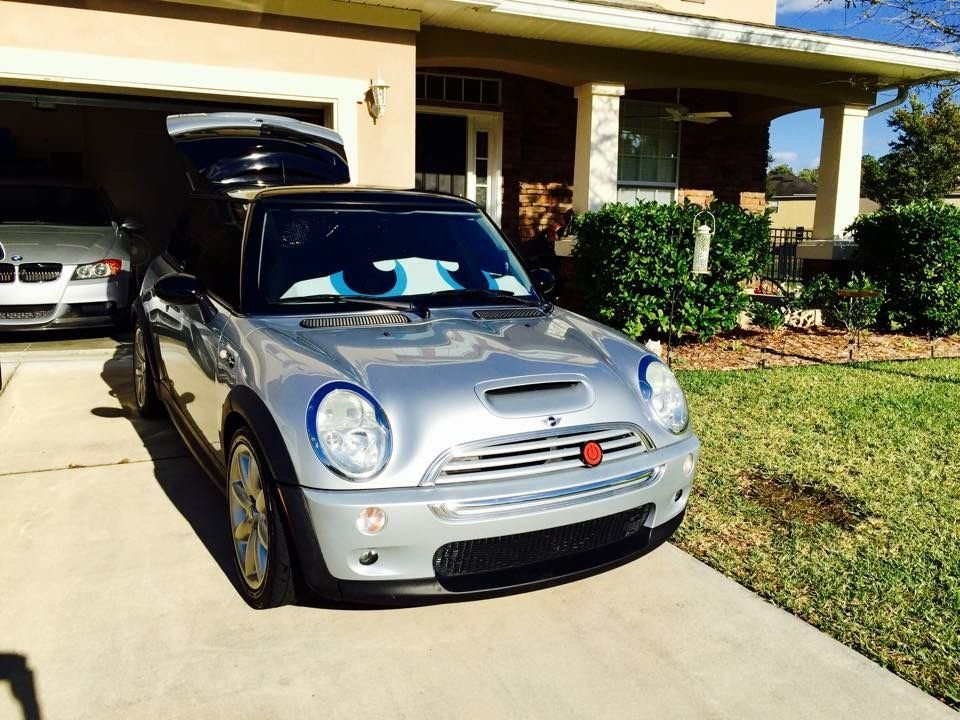

I'm having the same problem.
I'm having the same issue and really hoping for answers!
2003 Mini Cooper S manual transmission
169,000 miles
Purchased car Oct 2014
(No idea how well the car was maintained by previous owners)
I have changed the following parts so far since I purchased it:
- Bypass valve
- Spark plugs
- spark Plug Wires
- Coil Pack screamin demon
- Map Sensors (All)
- WMW super charger pulley package
- Timing chain tensioner
- Supercharger inlet tube
- Belt
- Hydraulic Belt Tensioner
- ATI super charger damper crank pulley
- Megan racing EZ coil overs
- Power steering pump
- Oil pan and seal
- DDM works air intake Kit
- M7 Oil Catch Can Kit
- PCV Replaced
- Rear Wheel Hub Bearings both
- back passenger fender light bulb and electrical outlet
- Polyurethane Motor Mounts (ALL)
- Taillights Euro
- Fuel filter
- Fuel regulator
(I'm using 93 octane and Mobil1 oil)
- checked for any line vacuum leaks, no leaks.
At this point the car is still consistently having issues with acceleration from 2,000-3,500 RPM. I haven't had any check engine lights come on. I try to accelerate and it feels as if I just let off of the gas pedal on and off as I'm reaching these RPMs it's the strangest thing. What other resolution is there?

I know you said you checked for vacuum leaks but check out this thread as I was having the same issue on a previous MINI and it was a simple fix when I found it. I found the same issue with one of my friend's MINIs as well.
https://www.northamericanmotoring.co...ml#post3724749

Thanks, checked it and the plug was in the hose thought it was ok but further checking it wasn't 100% air tight seal. Got it secure and now car is running way better. Silliest little detail. Glad to see it helped! Thank you.
