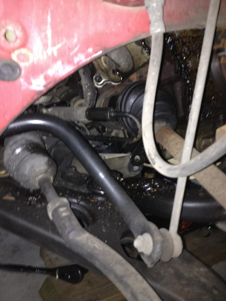

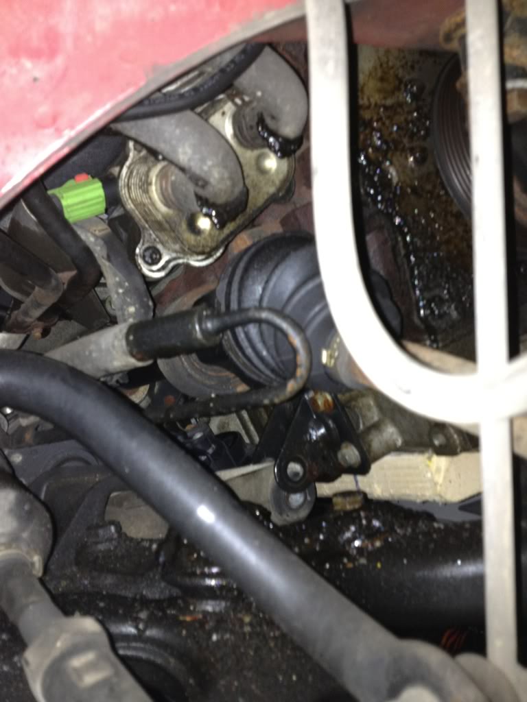

So I am experiencing low-end sluggishness.
I don't know where the MAP sensor is to clean it, but here's what happened.
This weekend, on my 03 Mini S, I added a 15% pulley, TSW upper motor mount and BSH lower motor mount. I get significant NVH, which I expected from the new mounts, but I get some major sluggishness on takeoff and when cruising at low RPM. This JUST started happening after I made the changes.
I did replace the serpentine belt with the supercharger pulley install, so it's not that. My car is leaking oil on the passenger side, but I can't tell from where. The bypass valve IS a Detroit Tuned BPV that I just replaced last year.
I have 112,000 on the ODO. Don't have a clue what it could be. Another member suggested that I look at resetting the "adaptives" so I am looking into that.
I have also reset the ECU and reseated the plug wires. Happy to report still no corrosion on the original coil pack.
I'm clueless and open to suggestions. Cannot afford to take her to a dealership.
Some pics of the oil leak and new parts.....

From what I can see of those pics that MINI was leaking more oil than a 30 yr old Harley.
~ Main bearing seal
~ Oil filter housing and "O" rings for the cooler.
~ I would put $ on him having a crank seal leak and oil pan gasket leak as well.
What belt is he using ? Is it the original or smaller one ?
He didn't have the problem until changing the right top and lower engine mounts with much stiffer aftermarket ones.
The original soft and worn out upper and lower engine mounts he just replaced could have been compensating for another undiagnosed rotational problem due to lack of lubrication and oil pressure......
Now only coming to light since there is nothing to absorb those rotational vibrations.
