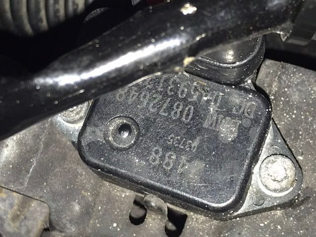

Can you buy two of the same sensors to replace the MAP and TMAP or is each sensor different and needs to be bought individually? I have replaced the MAP sensor (one near the thermostat) but I still have a CEL code for this. I replaced it before I realized my wiring harness had been attacked by a wee lil’ field mouse. Uploading pics so the numbers can be verified. I have not replaced the TMAP yet.
TMAP (near the intercooler)
MAP (near thermostat)
