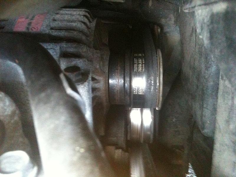

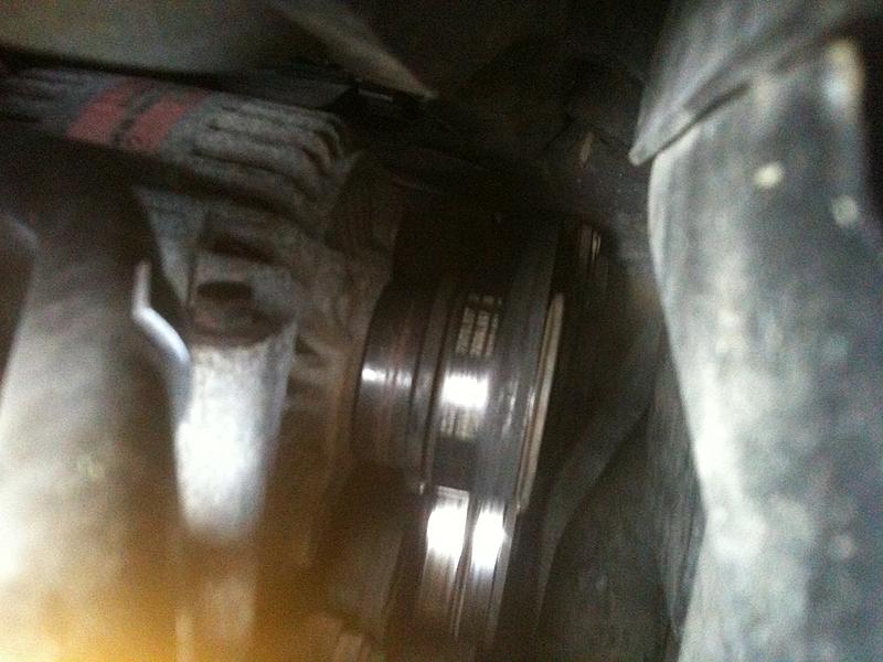

quick pics
Hope you can read the part number on the belt, and you can clearly see the wear on just one half of the belt. Do you guys think the noise is from the belt slipping? Is this minimal wear on the belt or is this very serious..
I already bought a new belt and will be attempting to put it on tuesday night, if not tuesday, it will be done on Thursday. i will post the results.

Putting a new belt on will likely be just a temporary solution...it looks like the belt is rubbing......you need to find the cause of the rubbing....and you are lucky you caught it before it broke..that does look pretty bad!! (not sure from the earlier posting, but I think you fixed it...rubbing tennsioner stop?).

YAY that's mee...again!!! Hmm the numbers on that belt look a tad weird as it doesnt look like a Napa belt.. I will do some more digging when our purchasing manager gets here today to confirm/deny that the belt is correct. Thanks!!

Just an FYI that is not the belt you purchased from us. It looks to be the OEM belt.
