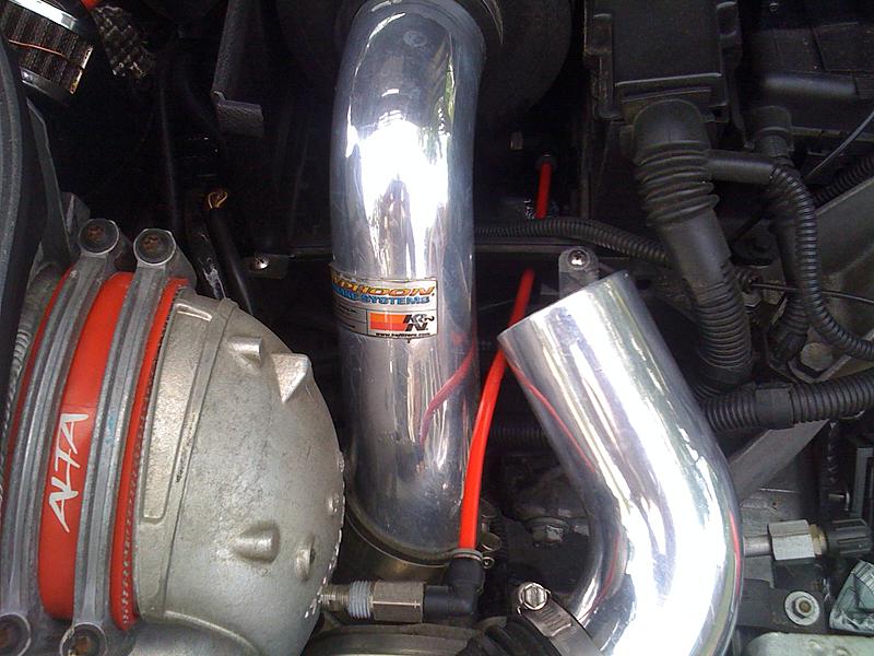

Just got my R53 yesterday. (first time mini owner). Like I said in my welcome post, this car is highly modified with alot of goodies like intake, exhaust, EDC (electronic suspension dampening system), aftermarket intercooler, etc....
But I am stumped. Upon further review, I noticed a coolant leak yesterday from a coolant reservoir tank that doesn't seem to belong or was added. I have the expansion tank (the cloudy yellowish one) but I also see another one stuffed in that compartment on the left side of the firewall.
There is red hose (actually it is a hard line) connected to the bottom of this tank that eventually leads all the way up next to the intercooler. You should be able to see in my pics. Does anyone have any idea what this is for? It seems like the tech at the dealership I bought it at filled this reservoir tank with coolant and the hose leaked everywhere there was a fitting. Any ideas? Thanks in advance.

Looks like that fitting on the intercooler "horn" could be a water/meth injection nozzle.
In your second photo, from right to left you have:
Alta Oil Catch Can (red hoses from top)
Aftermarket tank (Water/meth injection?)
Coolant Reservoir
Power steering reservoir (with aftermarket cap)
Also it looks like there is some sort of electrical wiring going to that white tank. Yes?
Jim

I would agree with Jim. From left to right; OCC, Water Injection, Coolant, and PS.
Based on your description it sounds like the water injection tank was filled with coolant. Since you said it leaked, my guess is that the water injection has not worked for a while so probably no concern. However, if it is working I would not think that coolant is the best thing to be injecting into the manifold/engine but it is also not the worst thing (not much different then having a blown head gasket that leaks coolant into the cylinders).
If the water injection system is working, it is not great for the pump to be operating with no water. You might want to make sure the system is not working (such as disconnecting the power) or replace the water tank and keep it filled with water.

oh crap! I know nothing of injection to the intercooler other than intercooler jet sprays. How will I find out if the water injection system is working? Underneath the K&N air filter, the hose coming from this extra coolant tank leads there and into some sort of piece and then out the other end of this piece the hose continues into the horn of the intercooler. Should there be some sort of trigger or button to activate the injection? Or can it be automatic as well?
Also the coolant not only was leaking at the coolant box but everywhere the hose had a fitting, like where it is attatched to the intercooler horn and where it is attatched underneath the air filter.

ok mystery solved. It is actually a meth injection system. When I removed the air filter it exposed the Snow Performance pump and I also found the controller. Not sure how if its operational. I don't see a controller in the cabin of the car. I'll be back with an update.
