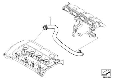

Once I got in the driveway I decided to pop the hood and staring me in the face was a disconnected PCV tube (I know this from reading the post on SeaFoam treatments) located on the passenger side which should have been attached to the crankcase. which looked to have been disconnected the entire duration of my trip. (Attached is a photo I swiped from the SeaFoam how to thread for reference.)
Well I reconnected the hose but I am not sure if I did so correctly. There is what looks like a plastic locking ring on the crankcase but I cant seem to get it to lock the hose in place. I fired up the car again and revved it slightly and the idle seemed to settle back to its normal level though not immediately.

Just an update for those of you that are interested. I brought the car back to my MINI dealer this afternoon and talked to them about the hose that had managed to work itself loose. Took them only a few minutes to determine that the plastic ring locking connector at the end of the PCV hose had completely snapped off of its supporting tabs. Even though I could reconnect the hose to the engine it would eventually work itself off again (as it did on the trip to the dealer) due to the fact that the locking ring was not effectively securing the hose in place.
Since I dont poke around my engine bay much I am assuming the hose got bumped or was inadvertently yanked when the car was being serviced. The plastic tabs holding the locking ring are pretty flimsy anyway so it wouldnt take much stress to snap them off as cleanly as they had been.
