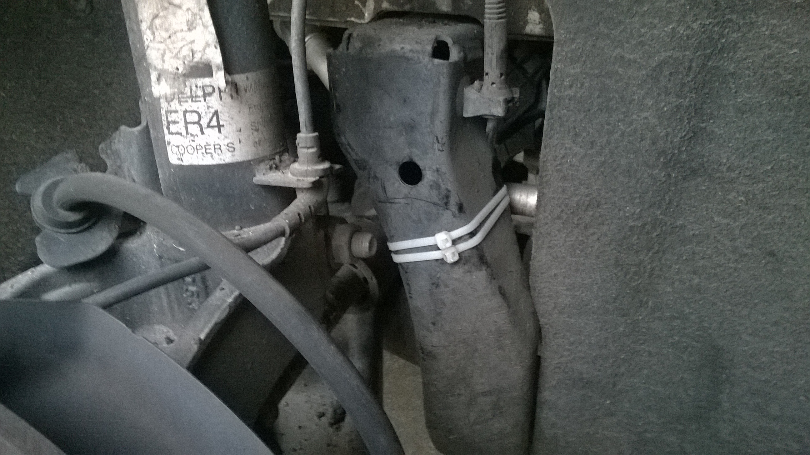

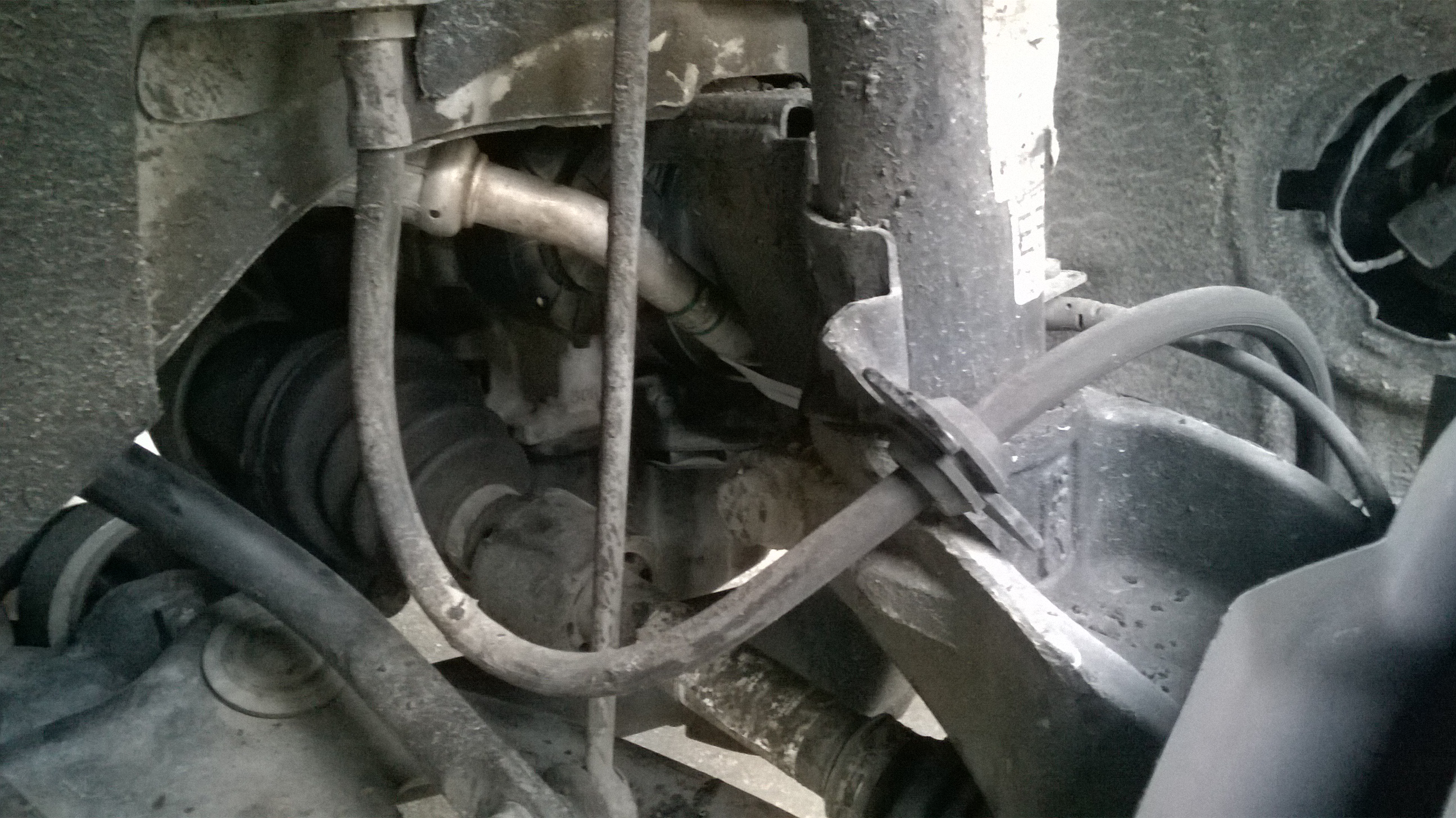

I guess its possible to hear it when the compressor is off but doubt it. It seems the vibration of the compressor is what causes the noise. Perhaps its the timing chain thing everyone else is complaining about. I am getting the timing chain tensioner (new version) in addition to trying to fix this compressor thing.
I tried using tie wraps to hold the compressor line down to prevent it from vibrating and it made things worse (so at least I know this is the culprit) perhaps I need to tie the tie wraps in a different direction. I just think buying a $100+ counter weight is way over priced.
Here are pictures of what I did and caused things to go louder, I think I need to use tie wraps to push the line down vs towards the wheel.

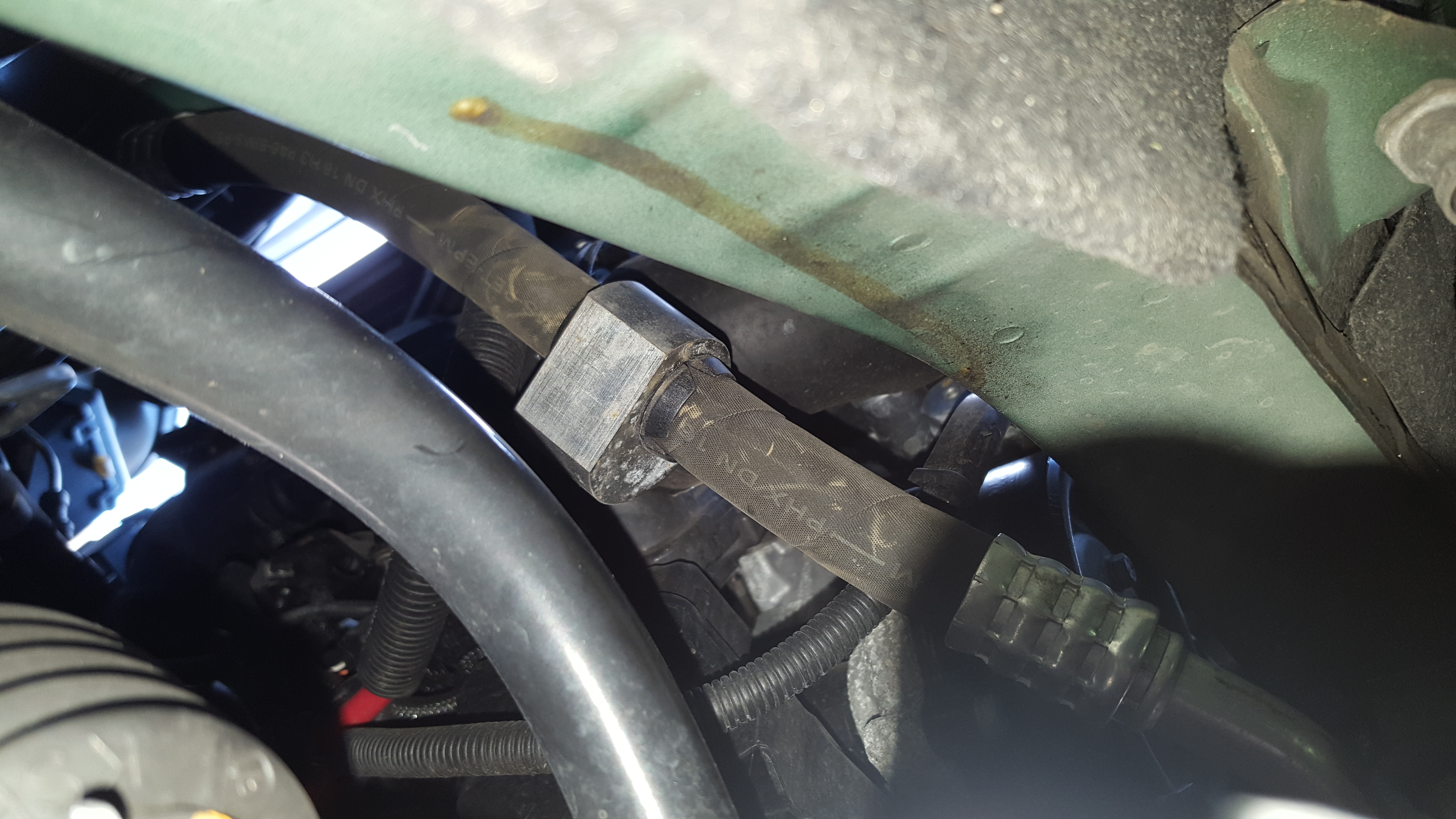

So, I've got a 2012 MCS that's making the exact same noise. I checked underneath it today to see if Mini actually decided to put the weight/damper on the solve the problem. Lo and behold . . .
Noise when turning A/C on?-q7fov5u.jpg
That sure looks like a weight/damper to me. Which now begs the question, why is it still making the noise? I didn't notice the noise last summer. I checked the fitment and it still seems quite snug on there. Any ideas?
