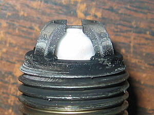

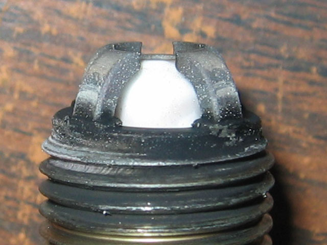

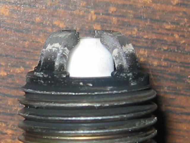

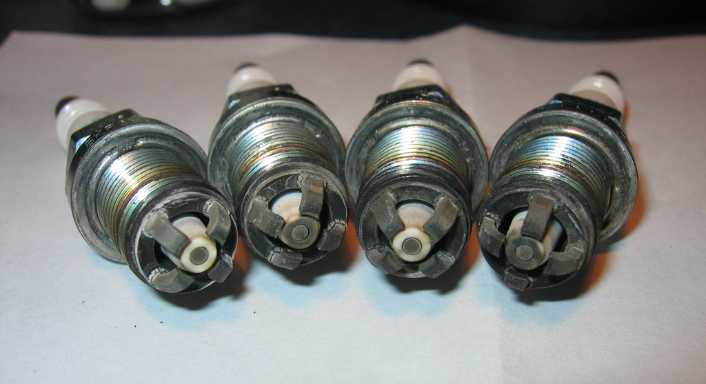

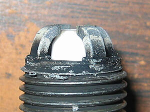

I took the car for a 10-15 minute drive this morning starting with a cold engine. Did a few good pulls around town. Pulled back into the garage and pulled the plugs and this is what I found (plugs are in order 1-4)
Looks like a lot of detonation, based on the white specs. I think I'm going to have the dealer reflash the ecu. My stongest guess is the timing advance is just too much.
Old Apr 16, 2010 | 06:32 PM
-=gRaY rAvEn=-'s Avatar
-=gRaY rAvEn=-
Moderator
iTrader: (43)
Joined: Aug 2008
Posts: 5,809
Likes: 70
From: Cape of Cod
All that crud make is difficult to see where the color change is on the straps. If it's at the base of the strap then you have too much timing....Is that where the color change is ?
I would definately consider a reflash of the ECU and strart fresh w/o that shark flasher.

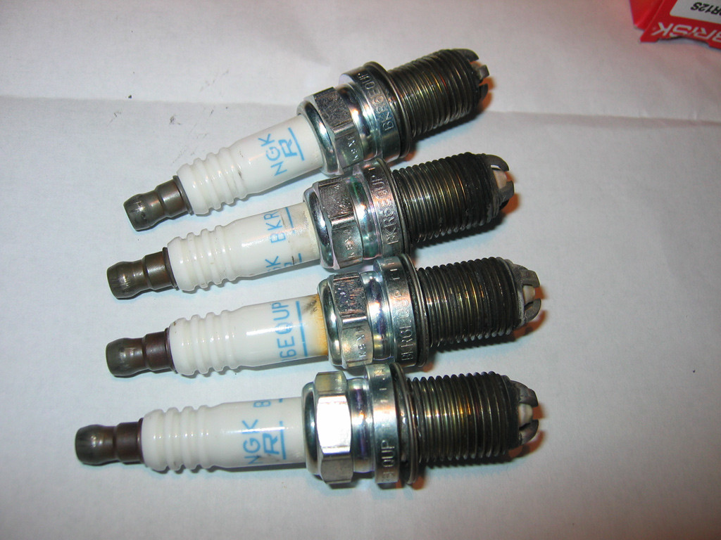

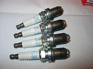

I just installed my Alta intake and Brisk DR12S plugs last night and this is what my BKR6EQUP's looked like. I haven't pushed the car at all over the past month, just normal driving really. These have about 3000 miles on them. There are about 6 darkened threads on them, so I was in definite need of colder plugs.
I'm curious about the inconsistent coloration on the ceramic from plug to plug.
What I have noticed is much smoother performance and quicker throttle response with the intake and plugs. The car did still feel slow, however. Ambient temp was 85 out, so maybe that accounted for something.

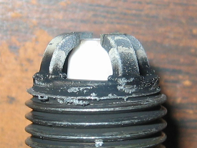

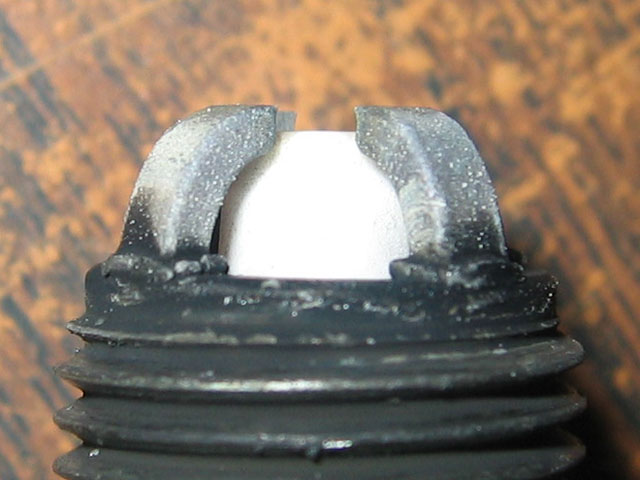

Also, check out the discoloration on the insulator. 2nd from bottom one:
What is that about? Just too much heat?
