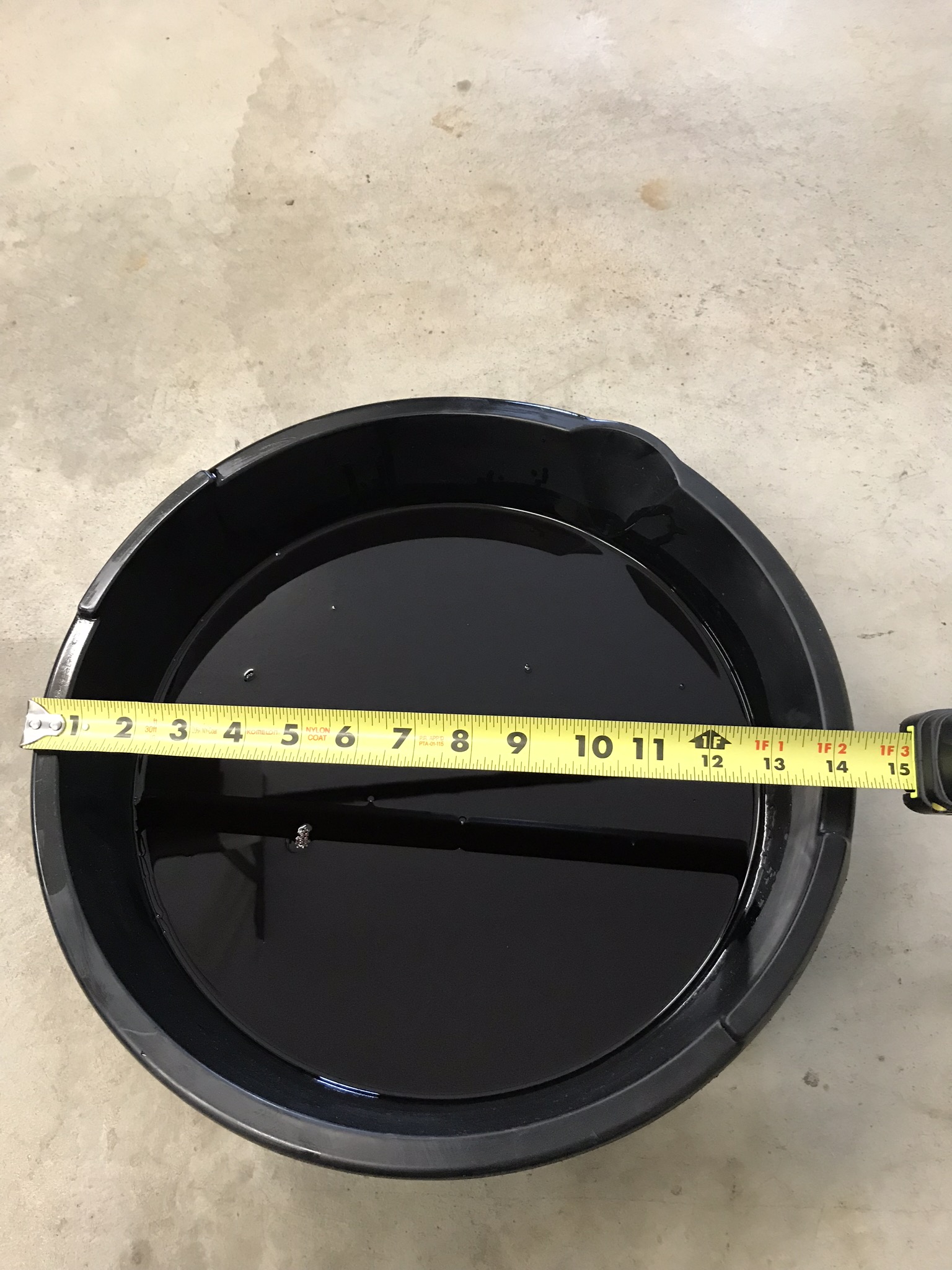

Ok I let the mini heat up (idle) for 25 mins. Used a kitchen thermometer and the fluid temp was 116. I would say about 2qrts came out. Needless to say this method did not work for me. There is an inch of fluid in this drain pan. I originally only added 22oz after mistakenly taking out the drain plug for about 10secs. I tried this method to make sure I didn’t overfill.

I measured what was in the drain pan,2qts almost exactly. From what most have said with drain plug and stand pipe out two qts is what they get. Maybe mine has the stand pipe delete option?
