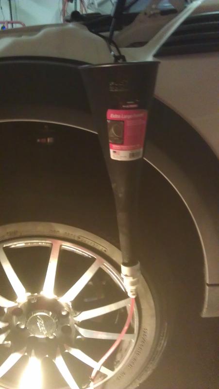

Did my second drain fill at 21k miles today. We found a great way to get the fill plug in out. We took a big slotted screwdriver and ground it down to fit the T55 fill plug. Now we can do a straight shot to the plug versus getting a T55 bit with a hex cap.
Bottom Fill after Partial Drain, actually much easier
I've done the partial drain twice and being the lazy guy that I am I thought I'd share my $13 solution
With the Car Leveled..
1. After you've removed the drain plug and the overflow tube (both use 5mm Allen) and let the trans drain..
2. Re-instal the plastic overflow tube (5mm Allen) (This is what you'll check the fluid level with, in later steps)

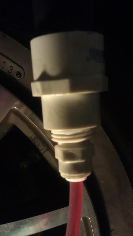

3 Wrap a couple turns of pipe tape around the 1/4OD X 1/8mip and screw it into the pan. (It's not metric but works perfectly, Lowe's part number 15118) (pic3)
4. Connect the 1/4 in OD line (Lowe's part number 443431) (pic3)
5. Connect the line to the funnel end (made with a trans filler funnel and (Lowe's part numbers 20514 and 126919) Zip tied to the hood strut... (pic1 and 2)

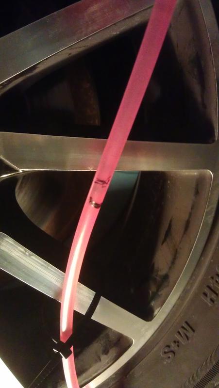

Here's the cool part.. Put a quart in.. wait for it to drain in.. and settle..
Now note the level of the fluid in the line....
That's the level of the over flow tube.... Magic
6. Mark the line with a sharpie. (don't move the line, that's why I zip tied the funnel)(pic4)
7. Now continue fill, one quart (or 1/2 quart) at a time.. check level on line each time.
Once it settles above the line it will be above the overflow mark... (that's ok)
8. Start the engine (noting that it drops below the mark) and thoroughly warm up the engine.
9. While the engine is running add fluid until it settles very slightly above the sharpie marked line..
10. While the engine is running, remove the line from the pan and let it drain until it slows almost to a drip.. (the purpose of the overflow tube)
11. While the engine is running, Re-install the drain plug
(For me it lost only about a 1/2 cup of fluid)
I took me about half the time, no special tools and I didn't have to clean the top of the transmission. Parts with pipe tape, epoxy (for gluing part to funnel) and hose parts it was about $13. Lowe's part list/receipt (pic5) (and it's reusable)
