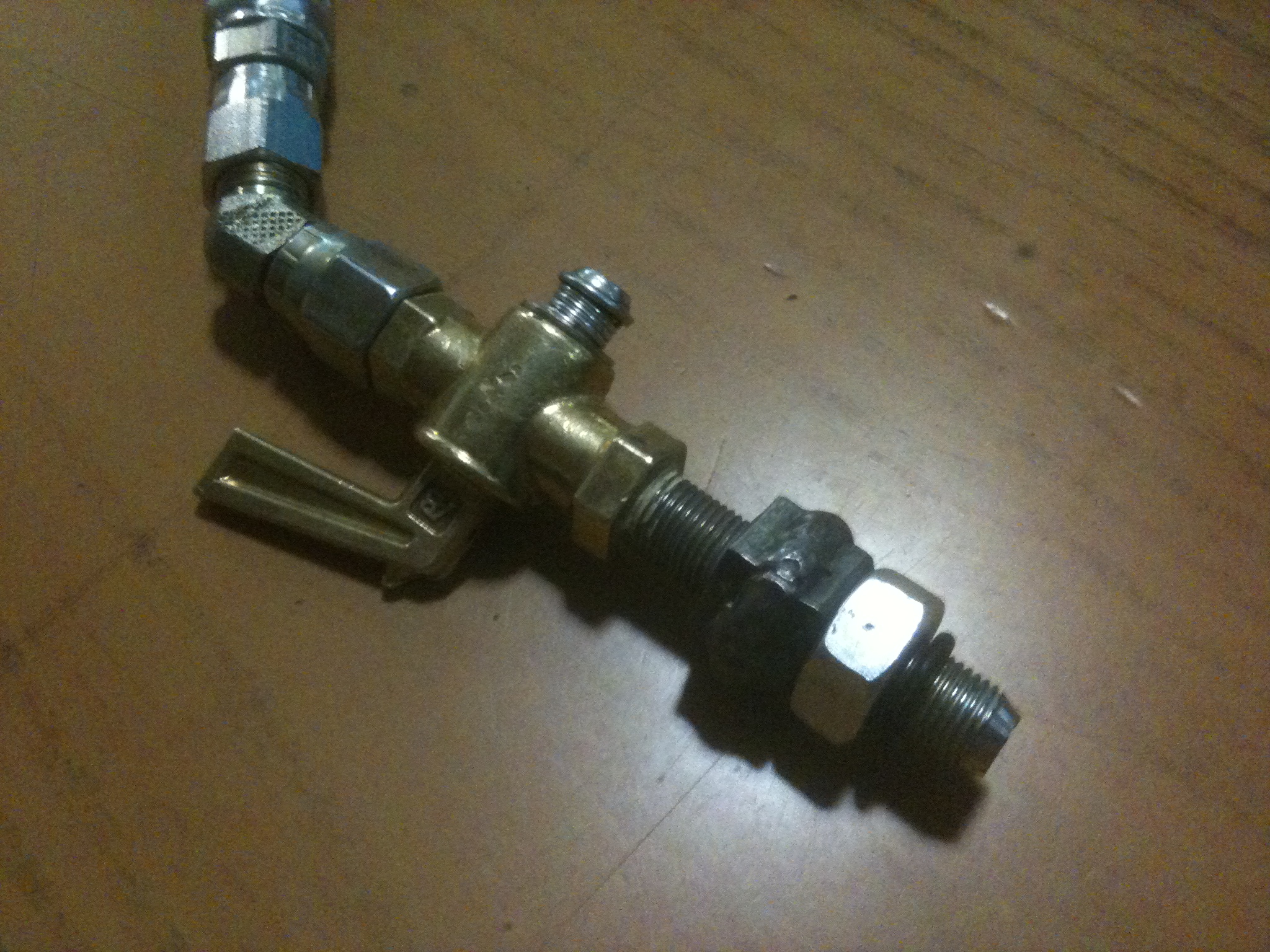

[QUOTE=JR2012IBB;4002235]Just for what it's worth I did this today all from under the car using the VW fill tool. I let it drain cold and 2 quarts 4 ounces came out. I had a pre-marked drain container to let me know exactly what came out. Using the VW tool and a small hand pump I pumped back out 2 quarts 6 ounces of new ATF fluid. The extra was to account for the 'line fill' in the pump. I quickly removed the VW tool and promptly put the drain plug back in, with a new crush washer.
Old Thread but after reading all the posts on this subject this seems to be the fastest and easiest way to change/flush the trans. I would assume doing this several times would replace most if not all the old fluid without removing the pan or upper plug hassle. Any new thoughts on this procedure? Thanks

Here's a pic of my homemade tool I'll use to refill/flush trans fluid.
Attached Thumbnails ATF Fluid - Partial drain/fill-tool-005.jpg

I had no intensions of removing the upper plug or removing the stand pipe, just puling the drain plug then refilling with slightly more, then removing the tool I made while the engine is running to verify the proper amount. Not to worried about the little fluid in pan since the majority of the fluid is in the converter and will take several drain/fill to replace.

How do you remove the stand pipe? Oh! I see you did say it just screws in, counter clock wise I thought I read someplace.
