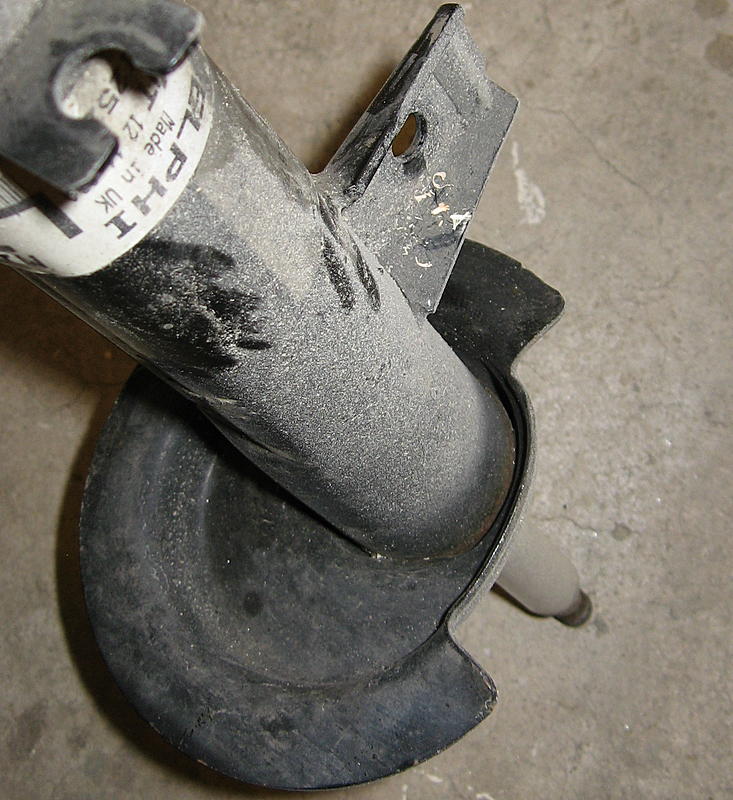

Stock strut removed from an 04.
Normal.

Oh wow, that missing part on the bottom looked like it was messed up. I guess its fine. But what was the other guy saying about the spring perch.

That is the insulator between the spring and spring perch. One big rubber piece that keeps the spring from having metal to metal contact with the strut.
