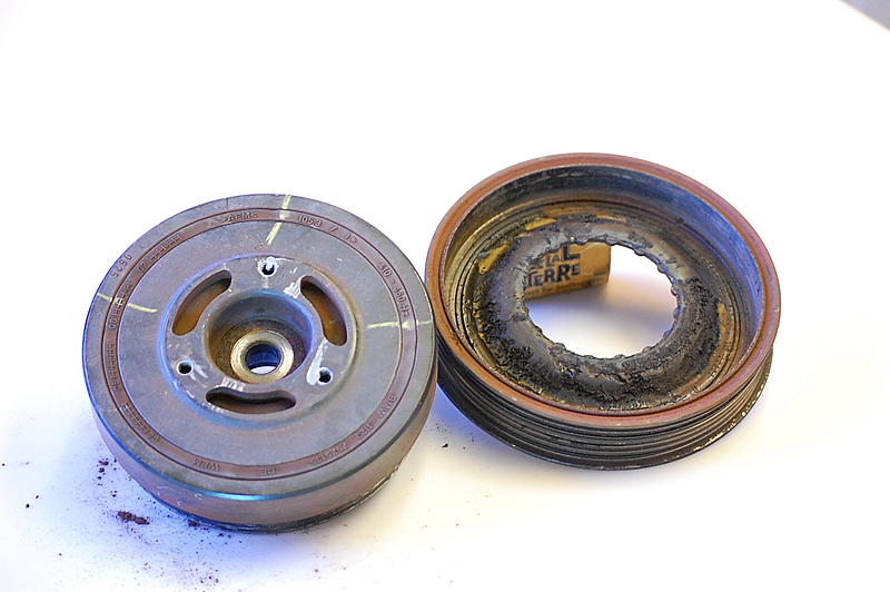

I tow a my 05 MCS behind my motorhome and I think I know what is going on. When you tow, I believe that the rubber dust that is on the road gets kicked up and blown every where on the Mini. Since the Mini is not running, it doesn't get burned off until you start it an run it for a while after towing. It's a slight smell that doesn't last for too long.
Now the sinister part - I have about 96K on mine and I got a really strong rubber burning smell the other day, along with a rattle that varied with RPM. Turns out my harmonic balancer was failing - it lasted about 50 miles after I first started smelling the burning rubber. I replaced it with a PRW 2510900 fluid damper, which cost about half of one from the local Mini dealer. If you have the tools, you can do the R&R in about an hour. I can send you pics of how the damper failed if you'd like.

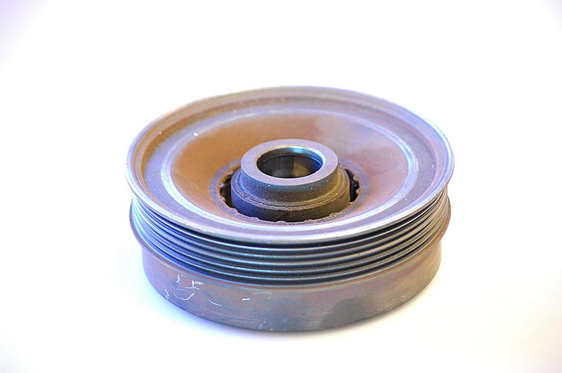

Here are some pics of my failed harmonic balancer:
I bought this balancer:
http://www.jobberwarehouse.com/sfi18...r-2510900.aspx
Here's how to do the install:
https://www.northamericanmotoring.co...oem-tools.html
Attached Thumbnails Burning rubber while sitting still?-dsc_5001.jpg   Burning rubber while sitting still?-dsc_5004.jpg   Burning rubber while sitting still?-dsc_5005.jpg
