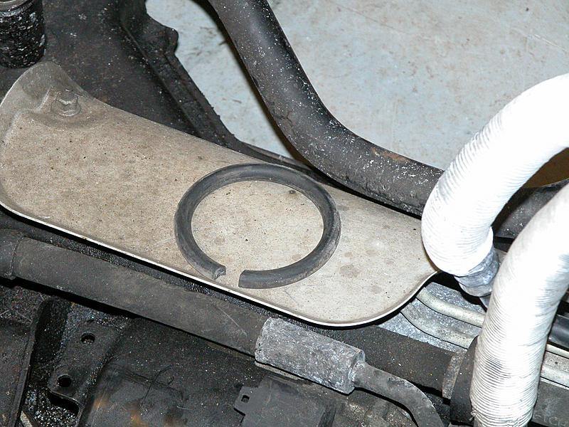

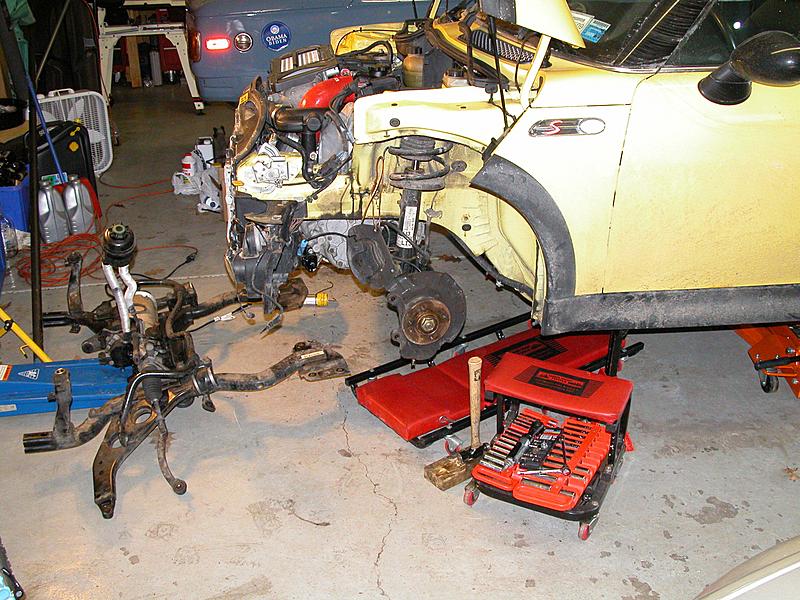

I dropped the subframe of our 2002 MCS today in preparation for changing the clutch. When I rolled the subframe out I discovered a broken rubber donut on the floor, about 3" in diameter. The second pic shows the donut on the subframe, although that's more for scale than geographic accuracy.
Anyone have any idea what this might go to in the engine compartment? It's either something that fell in the engine bay from a passing bird, or a vital component vital for full-function, national security, and world peace. I'd just like to find out where it goes...

Looks like a broken coil spring section. Check the coils in the front struts for a missing last loop.

Not a spring section; he already said that it is made of rubber.

Is there a part number on it?

OMG You were driving without that?.....................Just kidding.
Doesn't look like a mini part. I've had a many subframes out, but never seen an oring that size. It looks too big to be an oil filter oring. That's the biggest rubber ring in a MINI. I wouldn't worry about it too much.

Thanks for all the replies. The odd thing is there is no part # on the rubber o-ring. For a part that large it's very un-BMW. I mean un-Mini

Could it have come from the jack or lift?

I'm afraid so. First you have to drop the front subframe, then you can begin uncovering the transmission. Repeat after me, "I will not complain about changing the clutch in Rear Wheel Drive cars anymore". Repeat for several days...

I don't know if I should admire your guts for taking this on in your garage or call you crazy. That is not my favorite job, and I have a lift, and do one every 2 weeks. But to do it on the floor, no thanks. Good Luck to you.

Could it be a dustcover plate indicated within this diagram? (5, 7, or 8)
http://www.realoem.com/bmw/showparts...21&hg=31&fg=20

FWIW, I've had a number of MINI's in various stages of parts and pieces and I've never seen an o-ring like that either... it was probably bouncing a long the road and onto your subframe and you didn't see it. I've found all sorts of odd items when I drop Moss full-length skid plates we and most of our friends have... It's definitely not one of the dust covers in the previous post.

I think I finally identified the mystery rubber donut: it's a ring that runs around the circumference of the wheels on my AC Hydraulic jack. One wheel is missing the donut.

Yep. Not many people consider what's involved on replacing the clutch on a FWD car like the MINI. The tear down is considerable and this is a 9-10 hour job. The clutch and flywheel are wear/maintenance items.
Manual transmissions are fun, but be prepared to put up with this or spend the coin to have someone do the honors for you.
I agree with Way... You have to either be brave or crazy to do this at home.

Actually, it's been kind of fun. Kind like a giant jig saw puzzle. I enjoy working on my cars, and feel like I really understand how the Mini goes together now. I took my time and figured out each step. Plus, I noticed a bunch of stuff that needed replacing "while I was in there" that a shop might have passed by. However, we have a second car, so this has not left me stranded while I waited for parts (although I am in a bit of domestic hot water to get the Mini back in the driving rotation!).
The biggest drawback has been the weather here in Rochester. I can bundle up against the cold, but I don't feel I have the dexterity with mechanics' gloves, so my hands have taken a beating. The sacrifices we make for our cars...
