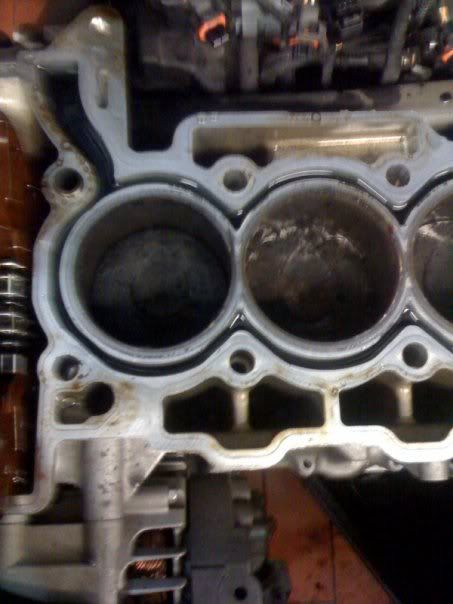

Right now my car has been in the dealership for almost 3 weeks. This is the inside of my car. This should not happen..... Serious design flaw.... :(
