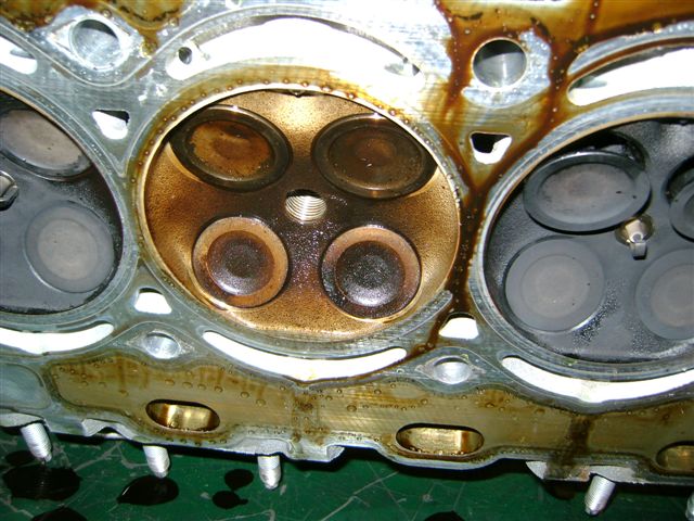

Does the carbon build up look anything like this?
Pics were taken from camera phone.
Even with cylinder head rebuild. Problem will re occur after so many miles. I see it in other car manufacture that uses the direct injection set up. The Lexus IS 350 uses direct injection in conjunction with port fuel injection. So this engine does not have this particular problem.

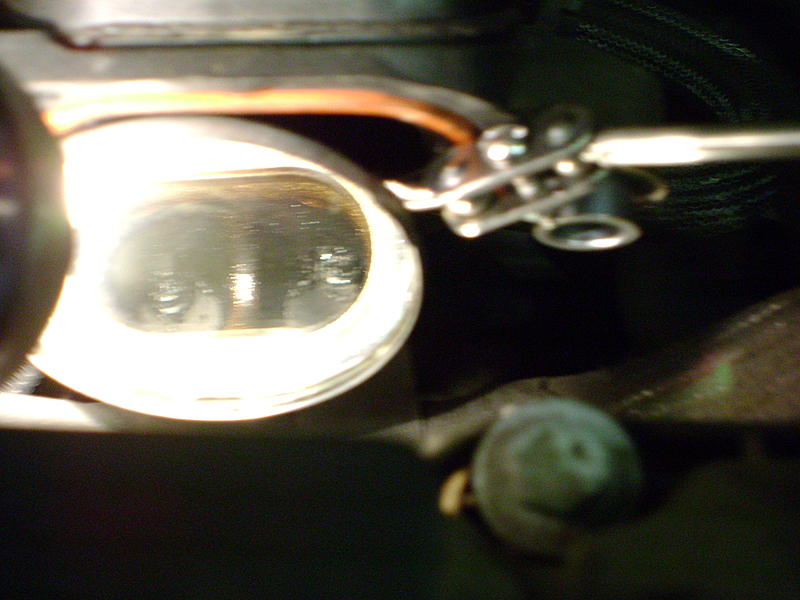

the issue with the N14's isn't so much from 'CARBON' but burnt oil on the valves, apparently the engineers are trying to find a fix for the way the PCV (positive crankcase ventilation) system works on the turbo engines, As it stands right now, oil is spewed out of the valve cover through the tube and shot into the intake right next to the #4 cylinder. If someone tells you that your N14 valves have carbon as a result of poor quality fuel, its bunk, on these direct injected engines, the injector sits below the valve and therefore the fuel isn't sprayed into the intake port, but into the combustion chamber itself; therefore avoiding fuel spraying onto the valve.
It burns onto the valves and disrupts airflow causing misfires on warmup and therefore a check engine light; here is what the oil deposits look like on an n14 valve. You can see how the valve stem is coated in oil sludge and therefore cannot seal very well, I've had worse cases where the oil was burnt to the valve sealing surface itself, almost to the point where the stem and the valve seat were the same diameter
(sorry for the sketchy photo) The first photo is of the #4 valves, the second photo shows how the injector sits in the head, its the little nub at the 12' o clock portion of the combustion chamber
(sorry for the sketchy photo) The first photo is of the #4 valves, the second photo shows how the injector sits in the head, its the little nub at the 12' o clock portion of the combustion chamberSpark plugs might have to be replaced from fouling on the plugs during that process right?
