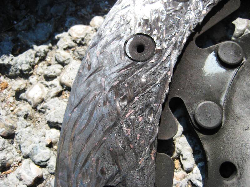

I need some clutch problem advice. I just purchased a manual mini cooper S in October 2007. It has 12,000 miles on it and I recently noticed that the clutch was starting to slip-the RPMs go up while the car barely accelerated. Just before the slipping started (a day or two before) there was some slight chattering or grinding noise as the clutch pedal was released to engage the clutch, also the clutch pedal felt like there was more back pressure coming up. I took the car back to Universal Mini dealership near me, who informed me that it will not be covered under the bumper to bumper warranty because they believe I drive aggressively, I don't. They said they can tell this by the cracks in the fly wheel and heat spots on the pressure plate. I engage the clutch with the lowest RPM possible without stalling & drive very conservatively. $3,200.00 later my Mini had a new clutch kit & I was able to retrieve the old clutch disk, pressure plate & flywheel (the throughout bearing went MIA at the dealership). What can I do in order to get my dealer to honor mini warranty? Could these problems be attributed to other factors, if so what? Has anyone had similar problems?
Attached Thumbnails Clutch Burn-Out & Noise R56 Pre-Mature!-clutchdskclsup.jpg   Clutch Burn-Out & Noise R56 Pre-Mature!-flywhlclsup.jpg   Clutch Burn-Out & Noise R56 Pre-Mature!-prespltback.jpg

Although I am no expert i can tell you that the clutch plate was overheated at some point and that is what caused the clutch plate to crack. My gf's sone did it to a Volvo with less than 15,000 miles on the new clutch. He kept telling us that it was not his fault until i got in another car with him and found he was "riding" the clutch pedal all the time. Just the slightest pressure on the clutch when it was not supposed to be bing touched was all it took.
I am also not saying that it was your fault because there are other things that could possibly cause it but it is likely that the dealer nor Mini USA will cover it as it looks so bad.

Sounds to me like your throwout bearing seized. It's possible than when that happens the clutch is not fully engaged when you release the pedal, therefore causing slippage, which in turn would wear out the clutch and overheat the lining.
I had a milder version happen in my 05 (premature wear due to a warped flywheel). It was all covered uner warranty, and so should your parts and labor. The missing throwout bearing sounds suspicious to me, since that's the part I would suspect first. I would contact MINI USA bout this and not let it go until they resolve it to your satisfaction. I would also insist the mia throwout bearing be found and returned to you.

dunno about r56, but the TO bearing in r53 is plastic. I had my share of clutch and flywheel problems to the point that I will never own another manual MINI (or BMW). And Ive been driving sticks 44 years.

By the way, my third photo of the pressure plate back side shows some sort of leakage spraying outward. This I think was from the T.O. bearing leaking grease that may have cause failure. :
I looked at that image and of course could not touch it. Were those streaks dusty or were they actually greasy? I have seen several clutches like this.
Sometimes, separating cause from effect is a difficult task. I agree that your SA should have gone to bat for you, that's part of his job to represent you and be the communicator between you and the tech. I think MINI will eventually help you on this problem.

It is mostly dust from the clutch disk following some sort of fluid leakage that I think is from the T.O. bearing. It’s too bad the dealership let the bearing go M.I.A.

Is that a dual mass flywheel (not a solid piece of steel like older, conventional flywheels)?
VW's have had problems with them.
They can self destruct for no good reason.
Maybe there is some fluid in there that helps with the damping.

Bingo.
They use DMF's that leak hydraulic fluid and destroy the clutch in the first 10k miles sometimes.
Your dealer will 95% of the time say you suck at driving and it's your fault. But at our dealer I goodwill alot of tranny repairs because I know how these things drive and even an abused clutch lasts alot longer than these are lasting.

I have the flywheel, where should I look for the hydraulic fluid leak? Does it leak out from a certain spot on the flywheel?

The flywheel has two halves and it normally comes out the middle right above the 'toothed' section

I'm not a mechanic but I grew up fooling around with cars. First, the center of the pressure plate(looks like daisy petals) seems to have had uneven contact with the throw-out bearing. Second, the friction material on the disc seems to have had wear only on the outer portion - the inner portion looks brand new. It looks like something was out of line causing the pieces to align improperly. This could cause overheating by slippnig slightly and overheating until the disc is worn to a point where it no longer grips at all and self destructs.

Viper, ittazvic makes a few good points. If your throwout bearing was out of alignment or not fully engaging, you'd more than likely hear it. You said the pressure felt different. Possibly something in the slave cylinder was sticking or jammed that kept pressure on the clutch assembly. How's the pedal pressure now and do you hear any noise coming from the assembly? Dan

Everything seems to be back to normal after they R & R the clutch assembly, but since it’s my 1st Mini I am not sure what normal is. The only difference now I think (& it’s a small one less than a 1”) is a little bit of free play as you just start to push-in the clutch pedal.
