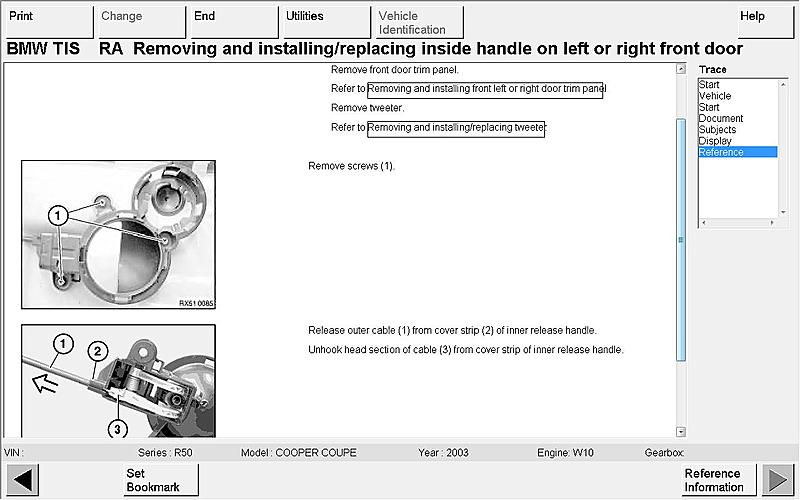

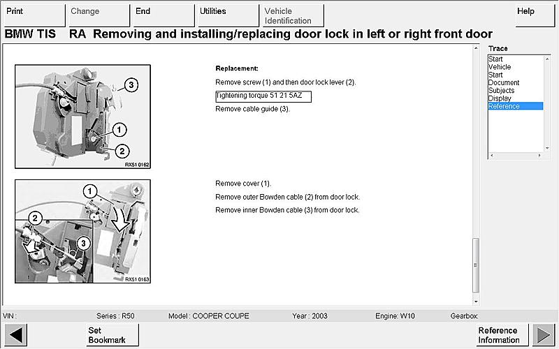

Bowden Cable Replacement
This is a response to a pm from sprung. I figured I would post it here cause it seems like theres more then one that needs some info. It seems pretty straight forward, I've done this repair on other vehicles and it wasn't that difficult.
The attachments are screen shots from the TIS service manual. If you can't read them or if you need some more info let me know and I can email you what you need.
