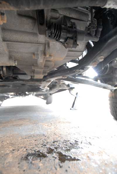

Jacked up car and noticed small amount of brake fluid dripping from the left front, in front of the wheel. If it is leaking, there is definitely air in system, plus it has likely failed.

There's Yer Problem!
Or my problem. A leaking Clutch Slave Cylinder. $68 at Century MINI in Greenville SC. Next to get a power bleeder, luckily we have a Harbor Freight up the road for a power bleeder...pick up cylinder tomorrow with wifes car....then on with with amateur night of automechanics with Bently manual in tow.

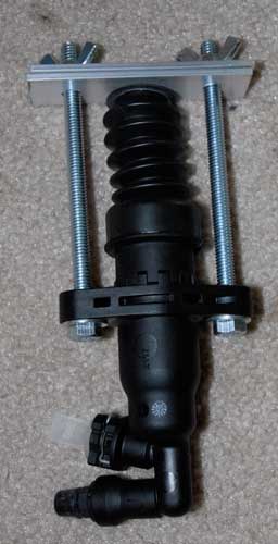

I made a slave compressor, see attached.

Originally Posted by joey1320
look at this thread and see my post(2nd one). you will really need some type of tool like that to help you bleed the system.
I made a tool to do it with, see attached. My results...not so good. Good enough to get it in gear and take it to a import shop I have seen MINI's at.
haha we don't have the special tool at our shop(no idea why since we are a mini shop... ) so i made one myself and it ooks just like yours. it gets the job done thats for sure!
anyways, sorry to hear that it wasn't all you expected but at least it helped. it can be a shitty job to bleed te clutch on these cars...
