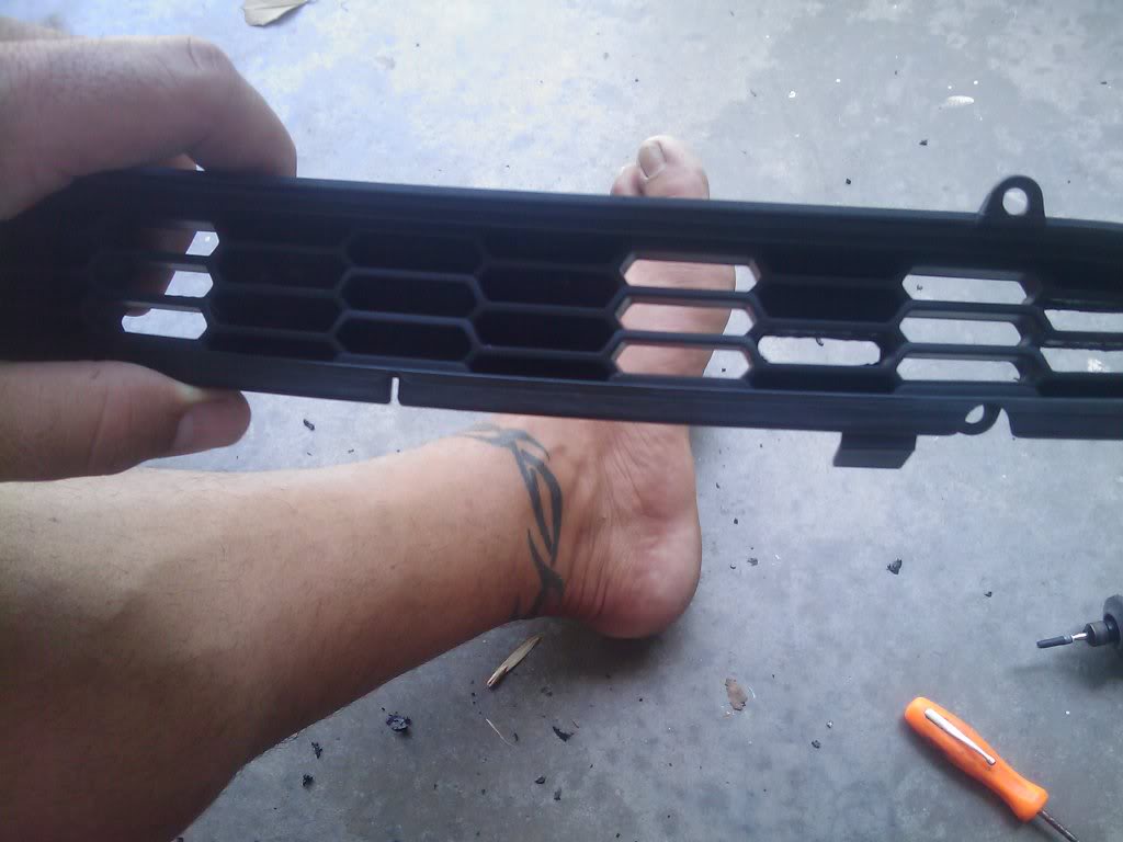

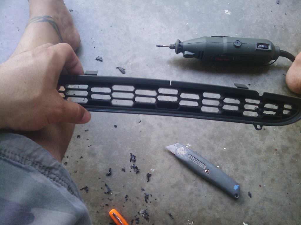

Old Mar 10, 2009 | 06:48 PM
  #89
orangecrush's Avatar
orangecrush
iTrader: (37)
Posts: 4,782
From: Charlotte, NC.
Originally Posted by iwashmycar
nice lets stay on topic.
anyone taken out the scoop insert?..the little grille thing. Mine has holes but not many..maybe ill drill the rest out
So far its fine, just being proactive
Doesn't help....
Here, I started removing them.
Here's the rest removed...
Not only was I trying to be proactive, I installed an aluminum heat shield (protective padding) to the bottom side AND installed a carbon fiber scoop.
Still warped. (not as much but still did)
Mark
