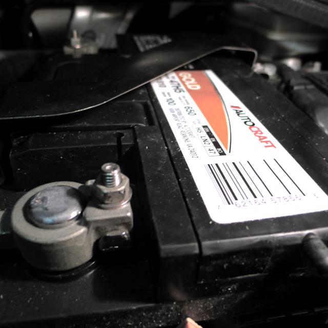

Today, on my 2006 MC's 8th birthday, the original battery was replaced with an Advanced Auto Parts Autocraft Gold battery.
The new battery was not identical in shape with the old one, but the vent hole was in the same position.
To secure it in the battery box, I had to wedge a 1/4" shim in the front and a 1/2" shim on one side.
And the bracket was not flush with the top of the battery--it left a 1/4" space. But I screwed in the bracket anyway and reattached the batterybox cover with no problem.

Added the Autocraft Gold 47H5 to the doesn't fit without mods list.
Thanks.

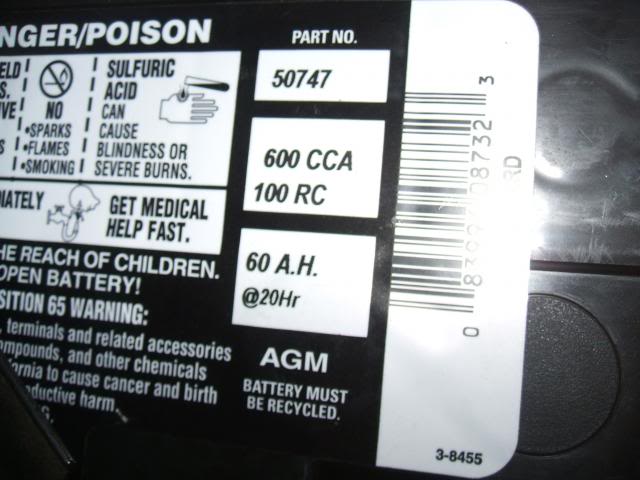

In an earlier post, I showed the original MINI battery in my wife's '03 R50. I did have to replace it this fall, and here's the one I put in:

The Sears part number is 50747 and it fits perfectly. Please add it to the "fits an R50" list.
Thanks-
Val
