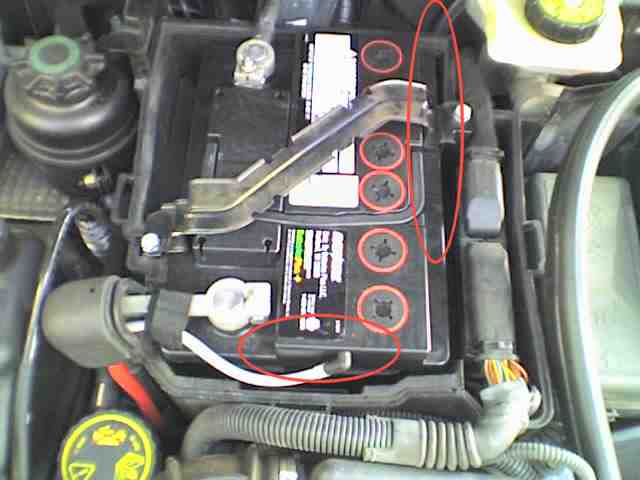

My 2002 Cooper found its battery thrill...
Originally Posted by joelimome
So the next step for me is to try this one at http://www.batteriesplus.com/p-36494...-sli47-li.aspx which looks to have the right ridge/bevel from the look of the picture.
Yeepee!
The batteried plus was an (almost) perfect fit.
They had in fact two models and their database seemed quite accurate in terms of what supposed to fit or not.
http://www.batteriesplus.com/p-36533...-sli90-li.aspx was reported as a good fit with a shim nuder it. I measured it and it was only 7" high, though had all the right attributes (vent tube and top case molding).
http://www.batteriesplus.com/p-36494...-sli47-li.aspx was reported as a snug, tighter fit, with no shim needed. It measured the right height (probably one or two millimeters too high) and I went with it. The fit was indeed snug, but almost perfect.
Kudos to them for having all the right info in their database.
$99 including core plus taxes
Here it is installed (I highlighted the vent position and the "bevel/ridge" on the hold down and the battery)
My quest ends there...
This may help someone else with a 2002 Cooper!
Old Dec 3, 2009 | 10:41 PM
  #81
prs's Avatar
prs
Joined: Feb 2004
Posts: 21
Thanks for the update and the pic. Very interesting about the Napa battery. I will give my local Napa store a call and ask about the dimensions of their 7547 battery. If the battery is like the one you saw and not like the one shown on their website, I will probably do like you and get the one from Battery Plus. I see from their website that the closest store to me is in SF. Thanks again for the helpful advice.
