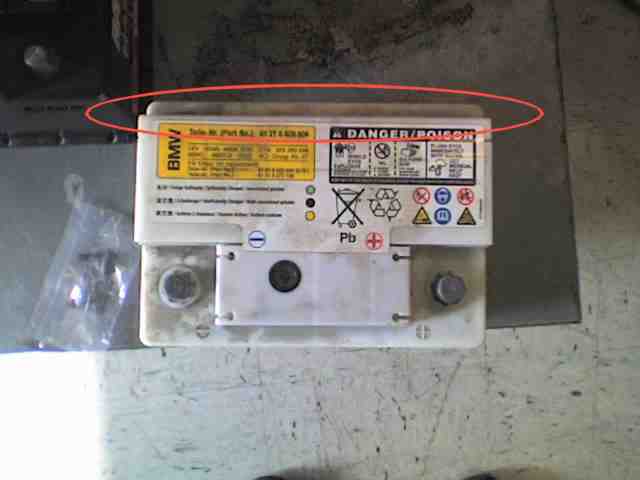

So I after reading all these post (and after buying and returning two batteries that did not fit my Cooper 2002) here are some thoughts:
Note: this applies to My Cooper 2002 and most likely not to a Cooper S, and possibly not to later Cooper models.
My Cooper 2002 was one of the very early models delivered in California... so you mileage may vary.
- most of the after market batteries sold by chain stores that are supposed to fit the Cooper DO NOT FIT.
- there are afew models that do, but they are quite hard to find, and often almost as pricey as the Mini/BMW branded battery.
The standard for the battery "type" is a 47, but this standard does not seem to be precise when it comes with to critical issues for a Cooper :
- the height of the battery
- the shape of the top casing moldings
- the location of the battery venting tubing
Height:
Most of the 47 batteries are too low, usually they come with a 7" height, when the correct height is more like 7.5" or 7 9/16 ".
So when shoping get a measuring tape. If the battery is not 7.5" forget about it. You could consider adding a shim under it, but this is cumbersome and may not solve the problem anyway because of the other issues usally found with batteries of the wrong height. Because of this height issue, you cannot connect the terminals properly without a shim.
Top casing modling shape:
Most of the 47 batteries in addition to being too short aalso have the wrong top casing shape. So even if they fit the battery case OK, and even if you add a shim under it to get the right height, you most likely will NOT be able to get the battery hold-down to fit. Usually this is because the attery top is too wide. The edge of the casing that is opposite to the terminals is usually flush, when it needs to be beveled.
This picture from a GOOD battery shows how there is a ridge/bevel on top; this ridge is where the matching ridge/bele in the hold-down fits.
Attachment 45031
This is another picture from my onw original battery, where I highlighted the ridge/bevel for illustration:
Attachment 45070
So now, a picture of one of these bad batteries:
Attachment 45030
On the "right" picture, top left corner, you can clearly see that there is no ridge/bevel : this means the hold-down will NOT fit.
