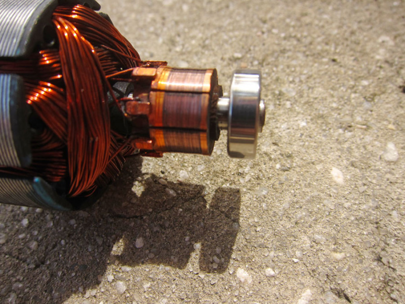

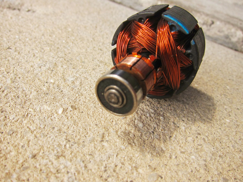

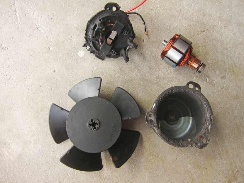

My PS fan started howling a while back so I ordered a new one. I decided to dissect the old one to see what is up with the bearings. The unit is definitely not made to be serviced. I had to drill holes around the fan shaft to get the press-fit fan off. Lots of prying/gouging was required to get the main housing separated. Here are the basic parts:
Most of the parts are fairly robust but they skimped on the bearings. Not very large. This is the bearing for the back of the motor.
A shame since the rest of the motor is in pretty good shape, including the brushes. Neither bearing felt particularly rough but they sure did howl when the fan operated.

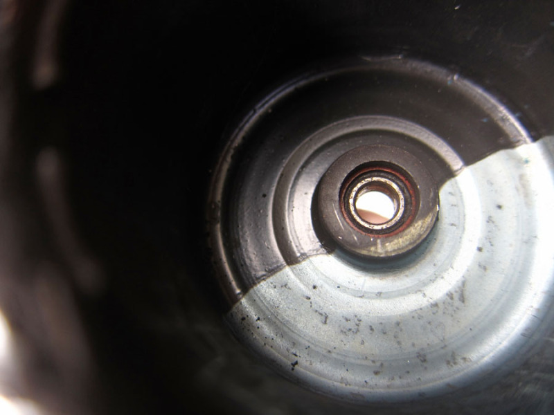

The bearing for the fan end of the motor is pressed into the housing. Unfortunately, there is no way to lubricate either bearing without disassembly.
