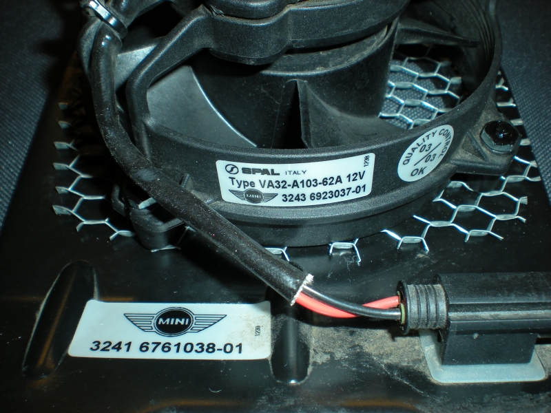

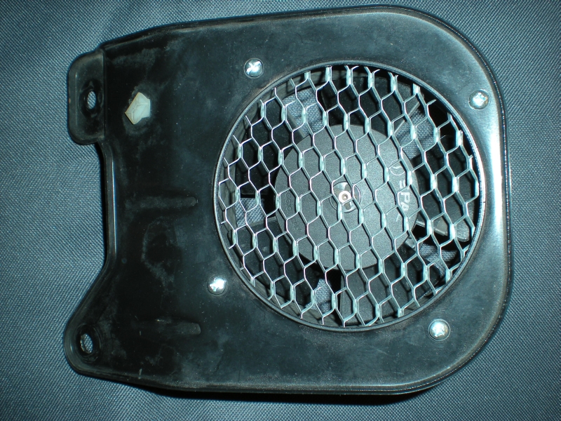

After seeing how low this duct mounted, I decide to just fabricate a screen only, from some scrap expanded metal stucco lath, and be done with it.
Attached Thumbnails Update: Inexpensive PS pump/fan fix-ps_fan_grille.jpg   Update: Inexpensive PS pump/fan fix-ps_fan_grille_side.jpg
