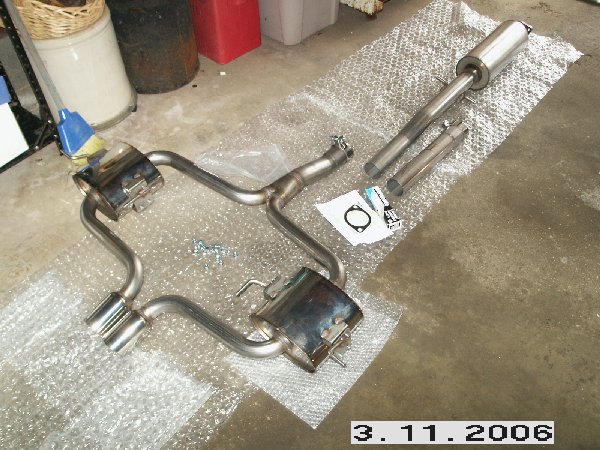

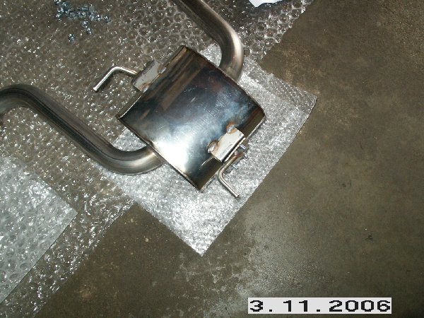

I recently bought the Milltek Quickfit for my 2002. Have had it a month in the box waiting for warmer weather and installed it yesterday. Quite a ways into the install it became apparent that I was probably sent the model for the 2004 and newer MCS rather than my older 2002. The mounting points for the split end of the system are only 1/2 right. Unfortunately, I've lost my return rights since I sat on it for so long. I also couldn't resist seeing it in action so I completed the installation minus the outer hangers. Sounds and looks great.

Just weld on new hanger if I were you. Very simple solution and that's what milltek does anyway, to relocate the hanger

Yes, the hangers didn't bother me and a fix is reasonably easy. The other issue is that the newer model turns up before the Y and just bumps into the frame where the suspension comes in from the wheels (I don't know the correct part term). Pictures of the system, probably the older model, shows the upturn immediately after the Y and flanged connection. It currently touches and creates a drone at certain speeds. If I go the route of hanger adjustment, I'll also space down the main pipe support plate 1/4" or so and drop the rear 1/2". Then all will be well.
The flange and Y of the older model system isn't as clean as the newer which I have. The Y is very straight and clean. I really can't decide because I love the sound and added couple horses with or without drone. I had also installed the Alta CAI with hose last week and I'm still testing how far down the road I'll go before I let off.

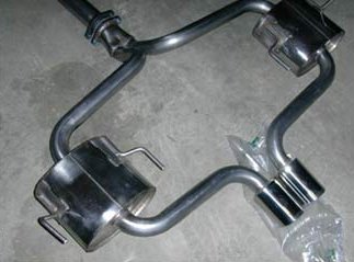

Here's a couple pics. The first two are the system I installed. The last one is from Outmotoring's website photo of the Milltek.
Note the configuration of the Y. The last photo is what I believe to be the system for the 2002-2003 MCS and it turns up farther back to clear the frame. Kinda messy with twisted turns.

A quick update: Outmotoring is working to have the correct hanger kit sent out to me as I probably received the wrong one. Therefore, I am moving ahead to get the system I have modified slightly and do not plan on selling it as I had indicated above. Some minor cutting and welding help from a fellow NEOhio motorer and I'll be in business.
