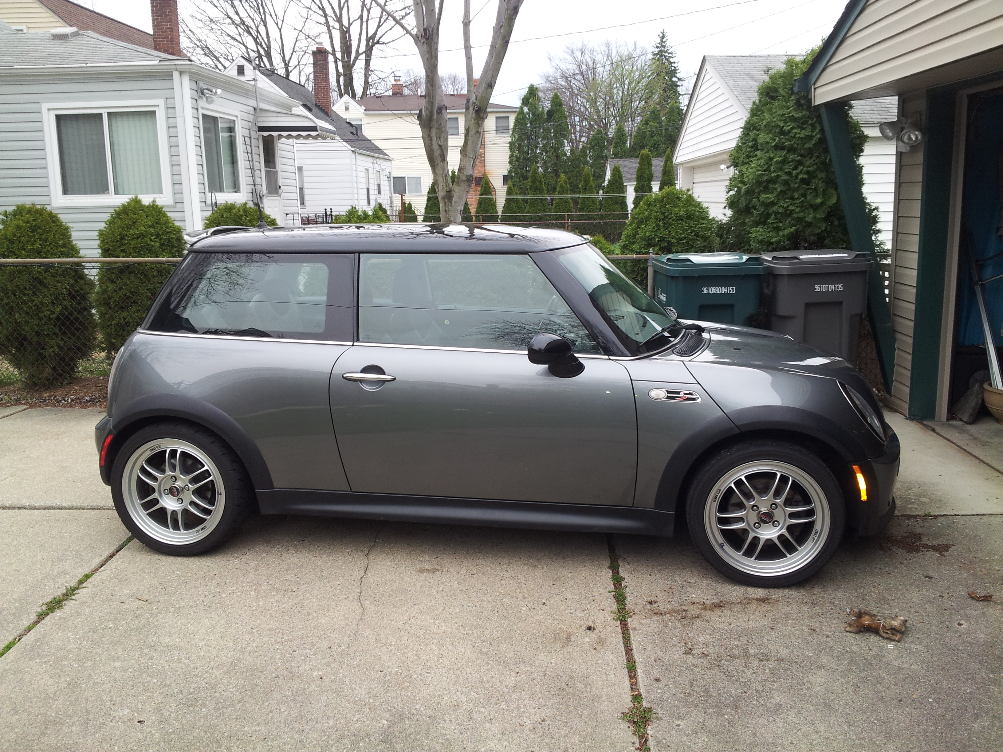

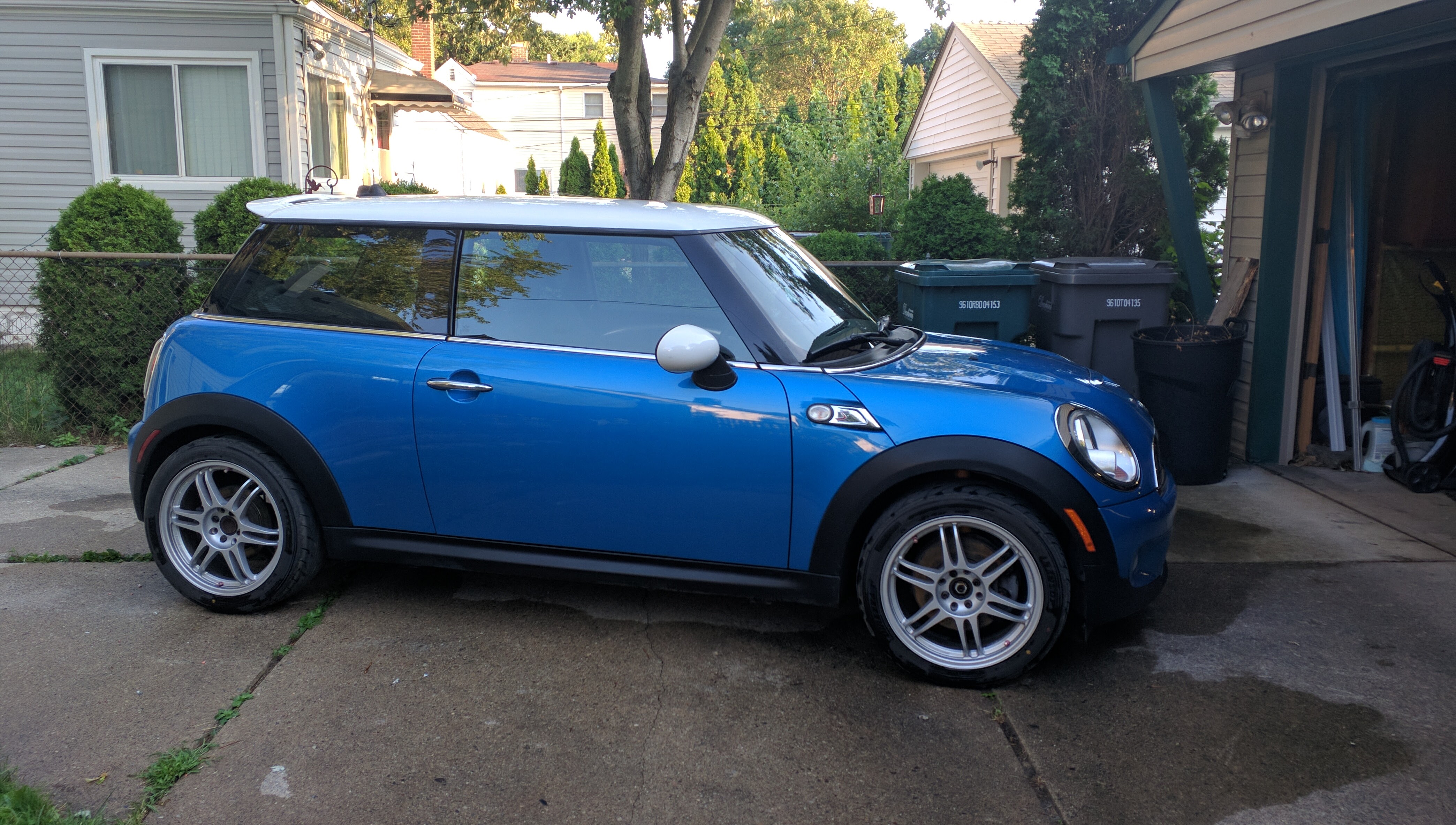

I ran the Enkei RPF-1 on my R53, I run the Kosei K1 TS on my R56.
Looks like The Advanti Storm is a decent option, but make sure you pick the legal offset (45mm, 35mm is too low and illegal for DS.) Based on the OE of 17x7 ET48, so you can go +1/-1 on diameter and +/- 7mm in offset.
Others have used the 16x7 option, I prefer the 17s with the shorter sidewall.
