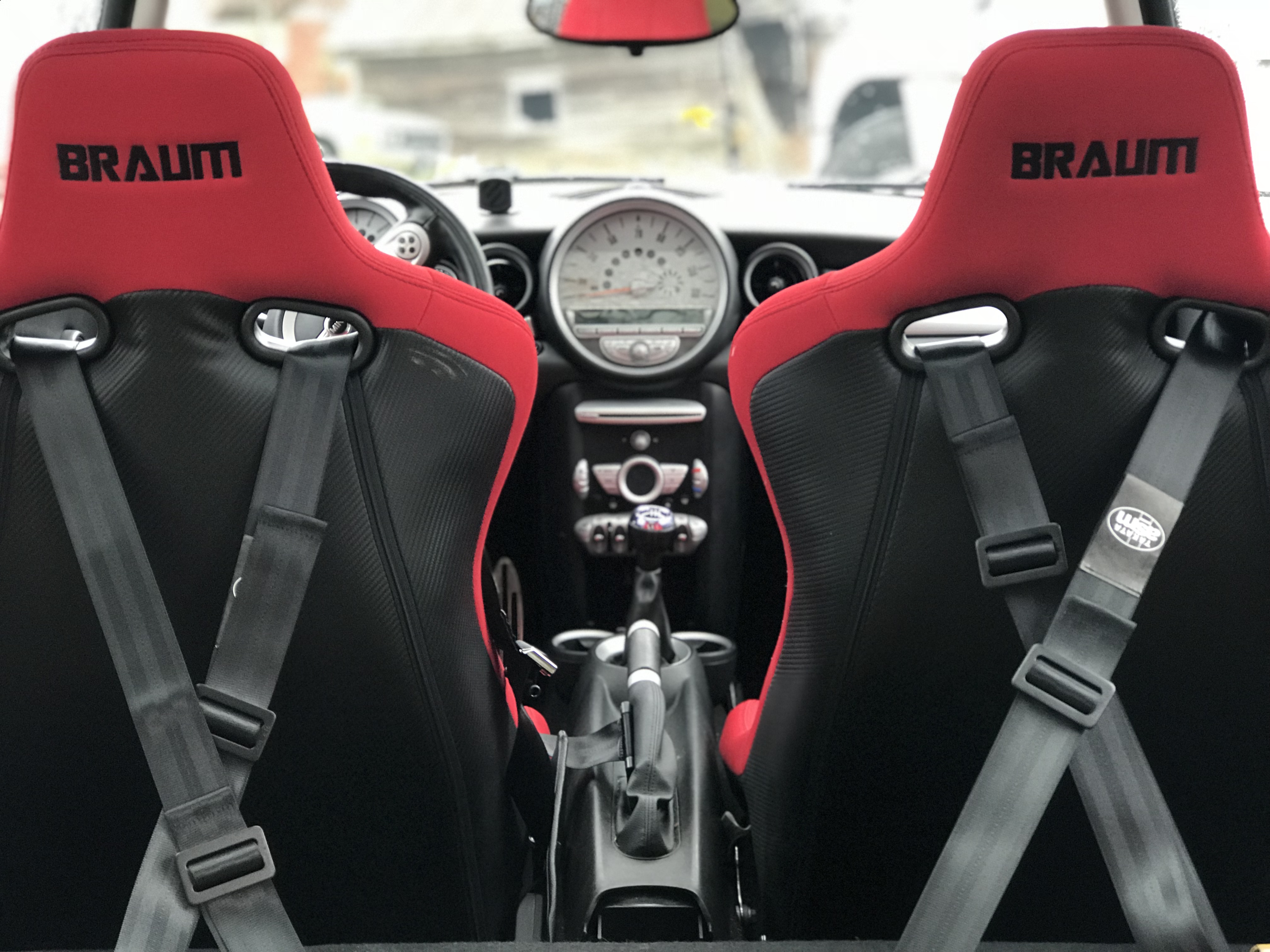

Making some changes to my SMF classed Mini. I’ve added some less weight lol OK maybe I replaced parts that weighed less. Sunroof I took out and plan on making a fiberglass or possibly carbon fiber replacement. Plan on making a pretty sturdy mold so I could possibly make more. Just throwing that out there. Not sure how much weight I will be able to lose but definitely don’t need more power. And adding some aero. I’m not doing this for solo national events just fun around my local regions. My first year 2017 I ended up 2.7 sec faster than 2nd place at my last event. Learned a lot and hopefully will continue to learn and have fun. Looking forward to 2018 season at NEPA SUSQ and CPR regions in Pennsylvania .

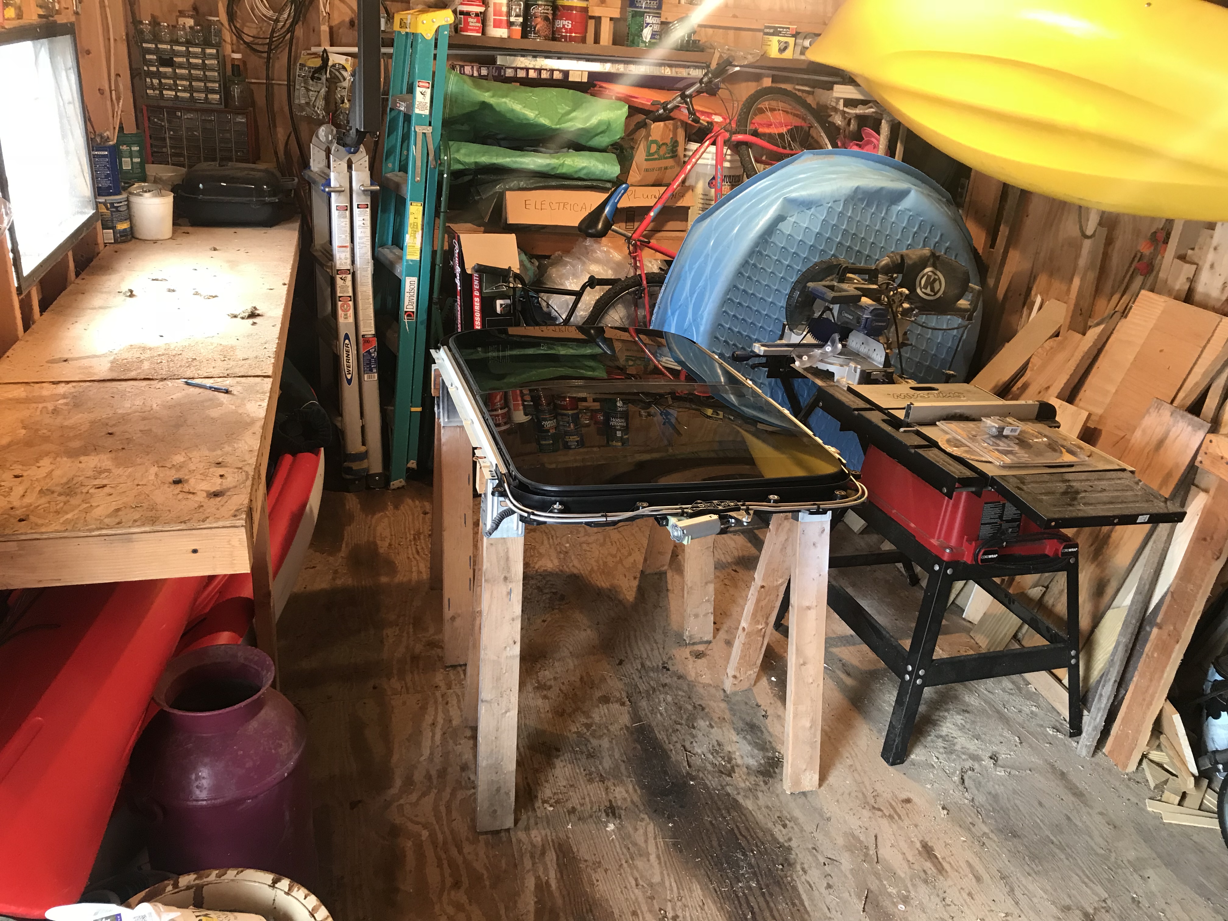

Well you’re in luck, if I happened to be OK at making a plug I have a R53 at the house to make one for that LOL. It will be a month or two at least until I really get things figured out

Sunroof is getting closer to being done as I’ve never fiberglassed before LOL I was actually going to have it done this past weekend but the vacuum bagging infusion had a air leak that I cannot find until I buy a ultrasonic listening device.

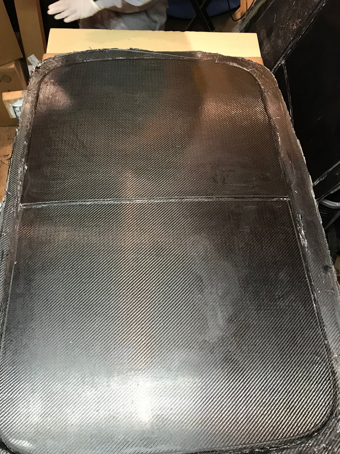

Finally got all my vacuum leaks figured out and finally have this fresh from the mold

Wow that looks amazing for a first shot. I assume you have to put some sort of coating on there to protect it?

thanks, I have a clear coat with UV protectant to be sprayed on probably this week. And I am going to add some reinforcement underneath and it should be ready to go in. But this one is going to a friend of mine that needs it before I do LOL it did take three molds until they were good enough to do the infusion. My son came up with the idea of doing the whole roof over the sunroof that way we wouldn’t have to worry about water leaks. Plus it would just look cool LOL

Just about done taking forever LOL this one isn’t even mine already sold. Ended up being 5 1/2 pounds
