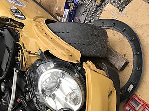

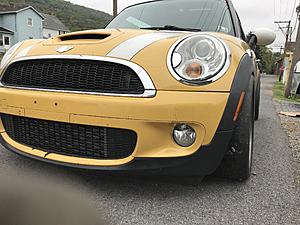

Hoosiers 225/40R17 FITS......
I have 2 weekends left and get a chance to use some Hoosiers. I was running Federal RSR's with pretty good success.

These tires are 1.3 inches wider in each corner, so its going to be interesting.

what wheels and offset are you running.
I ruined a set of these as they cleared in the rear until under full load the rubbed on the trailing arm. So make sure you check the inside after you run.

There 17x8 45. I went for a scrub in and they did rub on arm. So I bought 4 3mm spacers. Already have a 8mm and using a 15mm up front. Yes I definitely will be checking after first run. I mite just go with the 8mm from the start.

Thanks I ended up using a 8mm and probably need a 10mm spacer for the rear. 6mm rubed after first run going at a moderate speed. Put on the 8mm and was a lot better with just a slight rub and finished out the day with that. No rubbing on the outside. Tires stuck very well.
