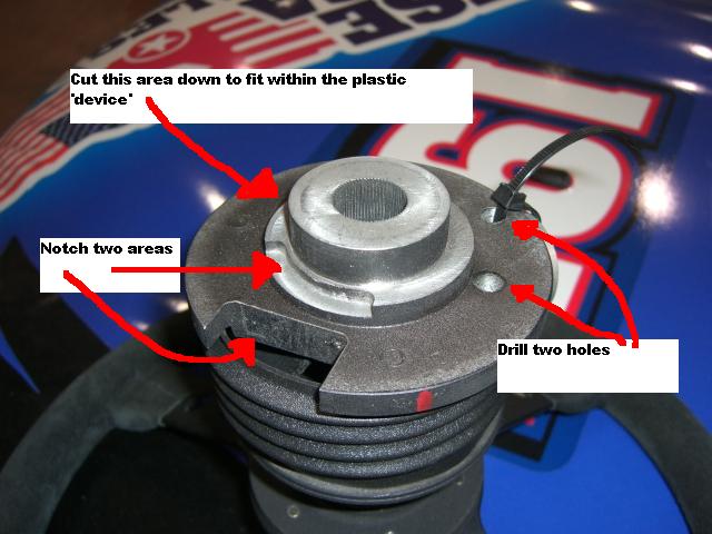

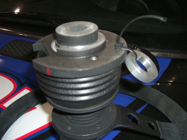

MOMO #2008
A few people have asked me about the MOMO 2008 adaptor and how it was machined to fit. If you do this, it will allow the turn signals to cancel and the horn to work. You will obviously need a wheel that has a horn button.
The adaptor WILL still work without the machine work but you must remove the plastic piece discussed below.
There is a rotating plastic 'device' under the wheel. This device protects the wire loom that carries the horn electrical and other steering wheel mounted electrical items. As you can see, you will need to cut down the outer diameter of the 2008 adaptor to fit inside the plastic device. You will also need to drill two oblong shaped cutouts. An additional hole will need to be drilled for a plastic post to fit through.
When you have the plastic device in your hand, this will all become obvious.
Lastly, and VERY IMPORTANT . . . when you cut down the diameter of the hub, cut as LITTLE as necessary to fit. If you cut too deeply you can weaken the hub assembly.
Hope this helps . . .
